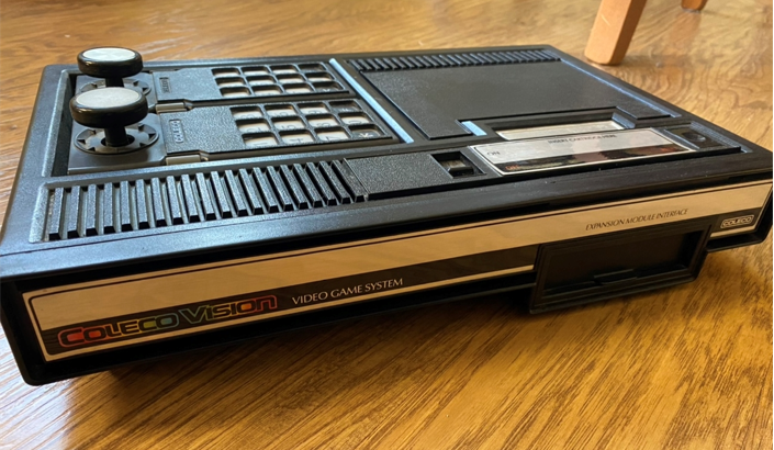

Edit#2: Look what I dug up from the basement! Gonna hook this back up this weekend and see how close the emulation really is :)
