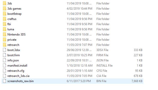

so i copied all the files off my 4gb sd card fine then formatted my 64gb sd card to fat32 using EaseUS Partition Master 13.5
i copied all the files back to the sd card this is what the root of my sd card looks like
but when i power on my new 2ds the blue light comes on then goes off
what can i do
