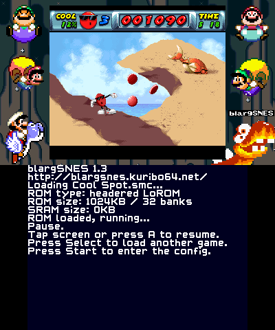

Lil' update...
I felt like trying to address some of the shortcomings of the hardware renderer. Namely, the graphical glitches that plague Cool Spot (and other games).
The game does a couple fun things:
1. Some of the screen area between the HUD and the game area is force-blanked, the game uses that area to upload a new color palette for the game area.
2. See the black bar at the bottom? Same shenanigans -- the game force-blanks the bottom of the screen to give itself an artifically longer VBlank time. Notably, it will begin updating its VRAM and OAM as soon as that black bar begins.
These are a problem for the blargSNES hardware renderer because it always does all the rendering upon VBlank, and uses the palette/VRAM/OAM as they are at that time. Hence the glitches in Cool Spot, for example.
What I'm trying to do here is change the renderer to render screen sections as needed. In a 'typical' game, the behavior should be the same (renders upon VBlank and that's it), but in a game like Cool Spot, whenever the forced-blank mode is turned on, we immediately render a whole screen section as required.
It's looking promising, but it's not done yet. Namely, I need to rework the way palette changes are detected. Right now, the tile cache considers that a tile is invalid if there has been any modifications to its corresponding palette, regardless of the actual palette contents. This could well be problematic for cases where the palette is modified midframe.

Some more work on the renderer! Cool Spot is nearly perfect. Two issues remain:
1. on the explanation screen, the spot character animation is glitched. It's because the game starts DMAing new VRAM contents a bit too early (scanline 208, while forced-blank is enabled at 209). blargSNES doesn't emulate DMA timings, and that's something I might want to look into (prolly gonna do it in a way similar to how melonDS does it, but that means I need to add a proper scheduler).
2. there are glitches in the subscreen, which manifest in things like the translucent balloon sprites. I'm sure this is caused by accessing the tile cache while it's still in use by the previous frame, and I'm not sure how to address this in a way that doesn't kill performance.

Okay, so for the day's progress:
You know the n°2 glitch I mentioned in the previous post? That one has been a ride. I spent all of yesterday trying to track it, messing with things all over the place, fixing some other bugs in the process...
In the end, it happened because the tile cache was being updated while still in use for the previous frame. I added a clever double-buffering mechanism to the tile cache, it fixed that issue and it doesn't seem to impact performance negatively. Well, I was told the DMA is pretty fast.

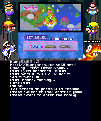

You know, that screen in Tetris Attack that was glitched? Well...
It's rendering correctly in the hardware renderer now. Took a bit of extra fix0ring.
