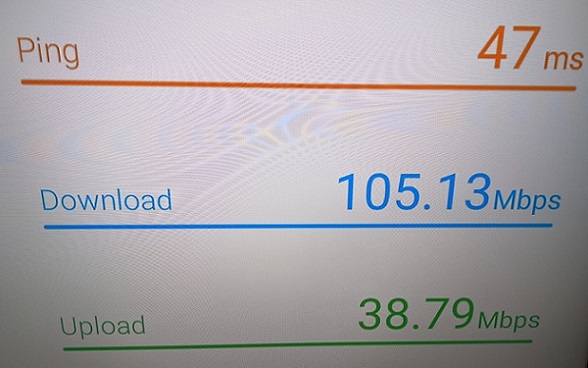

    wired ethernet speed test on Atmosphere 0.18.1, no USB 3.0:
    wired ethernet speed test on Atmosphere 0.19.0, USB 3.0:
    how is that even remotely possible??? 6 ms ping difference is whatever, but it's consistently slightly worse every time...
    and the download is consistently around 75%, and the upload 50%
    same speeds, ok, whatever, but 50% speeds?!? how does that make any sense???

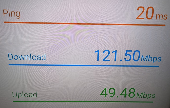

    I don't #*$(ing believe it
    Overclocking changed everything
    wired ethernet speed test on Atmosphere 0.18.1, full overclocking, no USB 3.0:
    wired ethernet speed test on Atmosphere 0.19.0, full overclocking, USB 3.0:
    this is absolutely mind-boggling and baffling
    both that the stock clock speeds give worse network connection on USB 3, and that overclocking on USB 2.0 practically doubles/halves everything
    I mean the 2nd part is kinda understandable, but the first part makes literally no sense
    also... 40% of the ping, +20% download/upload speeds on USB 3.0
    it's not nothing, but... shouldn't it be much higher than that?
