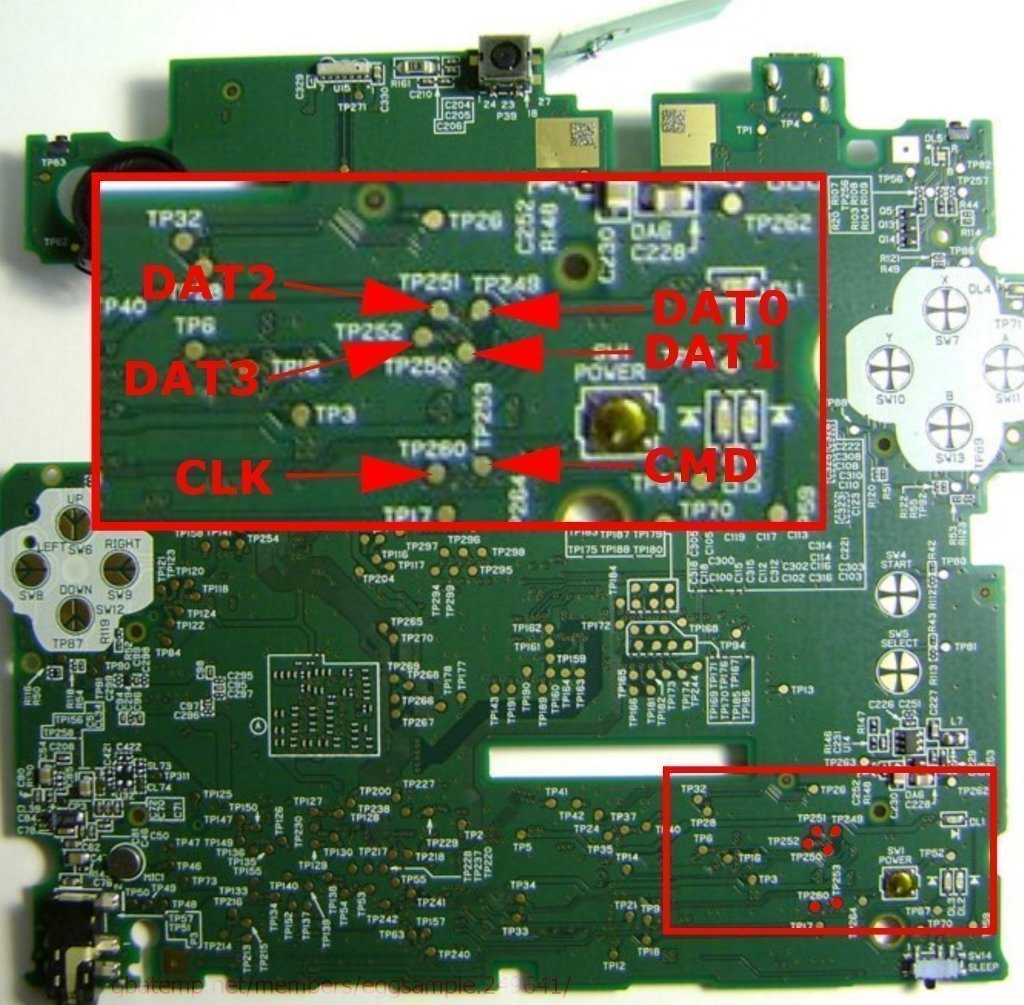

Possible 2DS NAND backup
According to description on the 2DS mobo and current nand pinout for 3ds/3dsXL I think 2DS nand backup should work.

Nice, man!
What USB adapter is that? You just have it hooked to ground, Dat0, CMD, and CLK?
Could I get even a MSPaint sketch?
Hi there, can you guys tell me how big is the NAND backup size of your 2DS? My 2DS has 1.21GB NAND size.
My 2DS is clean enough. I believe that the one that I got has different NAND chip. The one is probably the same as N3DS XL.
