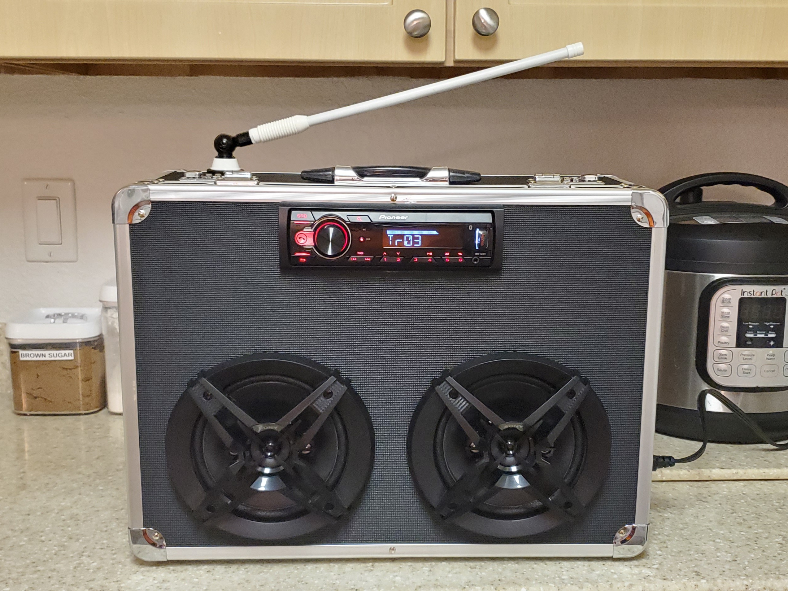

I was bored today, so I built a car stereo boombox for my garage.
I had already bought all the parts over a year ago, and had to pack them up when I moved in February of this year. I just got them out of the garage, and put everything together.
The most challenging part? I only have a 20v power drill and a small (small af) mini handsaw, as far as cutting the holes were concerned. It was thin MDF, so I had to wear a mask and safety goggles.I bought the storage safe box at Walmart for $40, and took the handles off the sides. I then reused one handle and moved it to the top, where a handle is expected to be.
I chose this Pioneer deck because it can play FLAC files from USB. (Apparently many decks still can't for some reason... I'm an audiophile for uncompressed music.)
I chose these Sony speakers because of how great they sounded in my last car. I don't even need a subwoofer, they just thump.

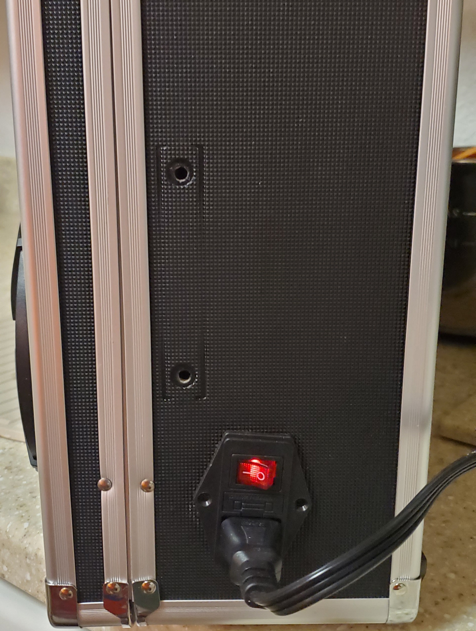

It's all powered with a 10A 24v power supply, and a stepdown 24v DC to 12v DC converter. The antenna is actually a marine antenna. I wanted something rugged and durable, so that's why I chose that. Upon installation, I added two washers inside of it so I can adjust it at will. Otherwise you're stick with a single position.

That's really cool! Would love to see the insides too. Like did you make chambers for the speaker elements? And are they enough or are you planning on adding smaller tweeters for the highs at some point? :)
Reactions: 1 person
I do have plans to add tweeters with passive crossover filters in the future, and building speaker chambers with air holes later on. But as it stands, the speakers already have tweeters on them in the center, and the sound is incredible. The reason you wear a mask for MDF is because it's basically dust and glue... Which when breathed in, is a carcinogenic agent. I don't want lung cancer, thanks.
