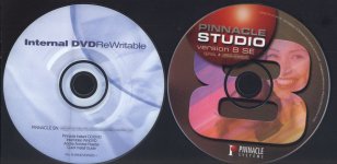

I haven't mentioned the name of the mystery drive I bought Saturday. Why? Well. See for yourself in the first picture. How I would like to work with the professionals for once…

Edit: Original packaging and bundled software (hopefully I made all software serials unreadable – else somebody could say I'm distributing "highly interesting warez")
That looks to me like it's from a cheap complete PC brand "Media Markt Network" from the late 90's.🤣
There were often "No Name" devices installed.
Reactions: KleinesSinchen
What… The second reason for buying this was the original packaging (and the mentioned software).
I'll edit the blog entry and add a scan of this.
The old laptop used for showing the success of fooling ProtectDISC CD with a normal CD-R had that strange "e" symbol as brand name you showed with the old Media Markt ad.
https://gbatemp.net/blogs/video-proof-as-good-as-i-can-for-the-last-entry.18936/
(The symbol is not shown in the video, just for reference: The laptop I mean is on video. Computer from the year 1999)
  • Haha
Reactions: Alexander1970
It could be a Spare Part...left from a time long,long gone.
(I am familiar with the "Repairing Procedure these days,we had lot of Leftover Parts left in the Repair Workshop when this Brand was "gone"....)
I am pretty sure,Pinnacle did not sold such Drive Packages....🤔
