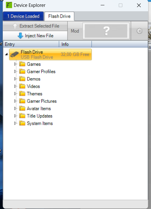

I use the original dash to format the drive, but it goes only for 32 gb. View attachment 332656
Not sure, but don't format external drive with the xbox. I don't know why it's not formatting correctly though.

So, sorry for the dumb question. This guide teaches you to update my xbox 360 kernel to the most up to date?
Yes. Though as mentioned you don't an up to date system in order for your external usb drive to be read..
My xbox doesn't format my external drive above 32 gb for me use as a source of games
So your system is not reading the usb? Does it show up as unformatted in system settings?
It should be in a FAT32 format btw, and try plugging it in other usb ports. If you're using an external hdd, make sure it's getting enough power, use something like a y-cable to power it.
Thanks cool me, I will try that. I've tried only two usb ports, Will try the rest. I only have the option to format on original dash for 32 gb, the rest doesn't show. I will try your tips.
What rest? You it doesn't show your internal hdd? If that's the case, are you sure it's formatted? It'll show up as unformatted if it's not. If it doesn't detect it at all, then there must be something else, like the hdd is not fully connected to system..
