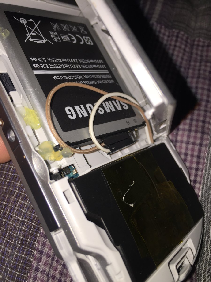

    I did this a couple months ago with my $10 psp, i was told the umd reader was broken... so i pulled it out and decided to shove a battery in..
    I know it being held in with hot glue looks awful, but i didn't care enough to remove the UMD door and glue it properly
    and i used 2.5mm headers and jumpers to make it easily detachable.
    Ryccardo likes this.

    That looks hella good. So you have 3 pins on that battery right?

    There are three pins on that samsung battery, but i only used the pos and neg pins.
    I wired it directly to the psp cell within it's battery, so it should use the protection circuitry of the psp battery/psp
    elBenyo likes this.
