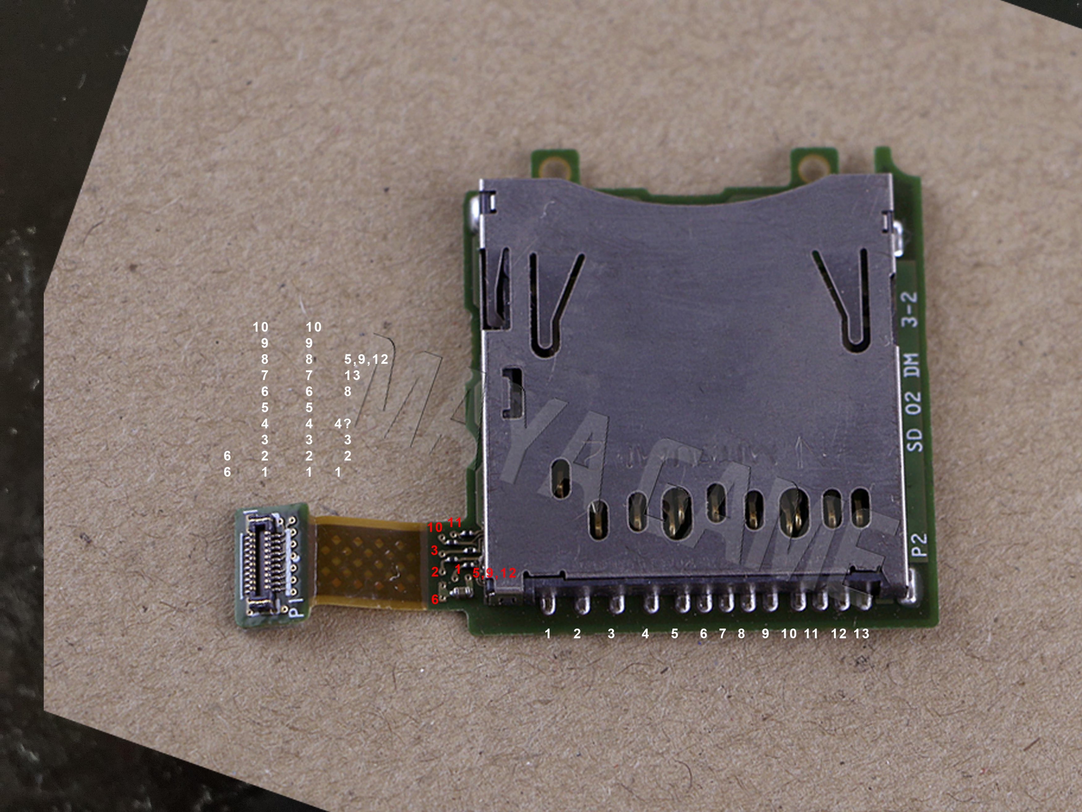

    Hello, peeps. I've been looking around Google, and also this forum, but I haven't found anything regarding the specifications/pinout of the O3DS SD card reader.
    I was looking around for a spare SD card reader for modding purposes, and I remembered I have this destroyed O3DS laying around, and I thought I could use that, so I desoldered it. The problem is that the card reader has 13 pins, and I cannot find any information regarding it. As far as I can tell, it's just a normal SD reader, but I need to know if there are some specifics to it. Here's a pic of what I think the pinout is (relative to the SD card's pins), going by simple observation:
    [​IMG]
    Anyone knows if this is correct? Can anybody shed some light into the specs of this? Also, what are the last 2 pins for?

    the write protect pins I would imagine

    I noticed that the right-most pin seems to be the "sense" pin (the one that notices if the card is inserted). I'm still in the blank regarding the 2nd right-most pin, and I don't want to destroy the reader just to find out lol.
    EDIT: You were right. After some experimenting, I came up with the following:
    [​IMG]
    The two pins I labelled as "s" are write-protection pins. Inserting a card with the tab set to "locked", causes the copper thingy at the right side not to touch the top part, whereas unlocked, it does.
    Thanks for your input!
