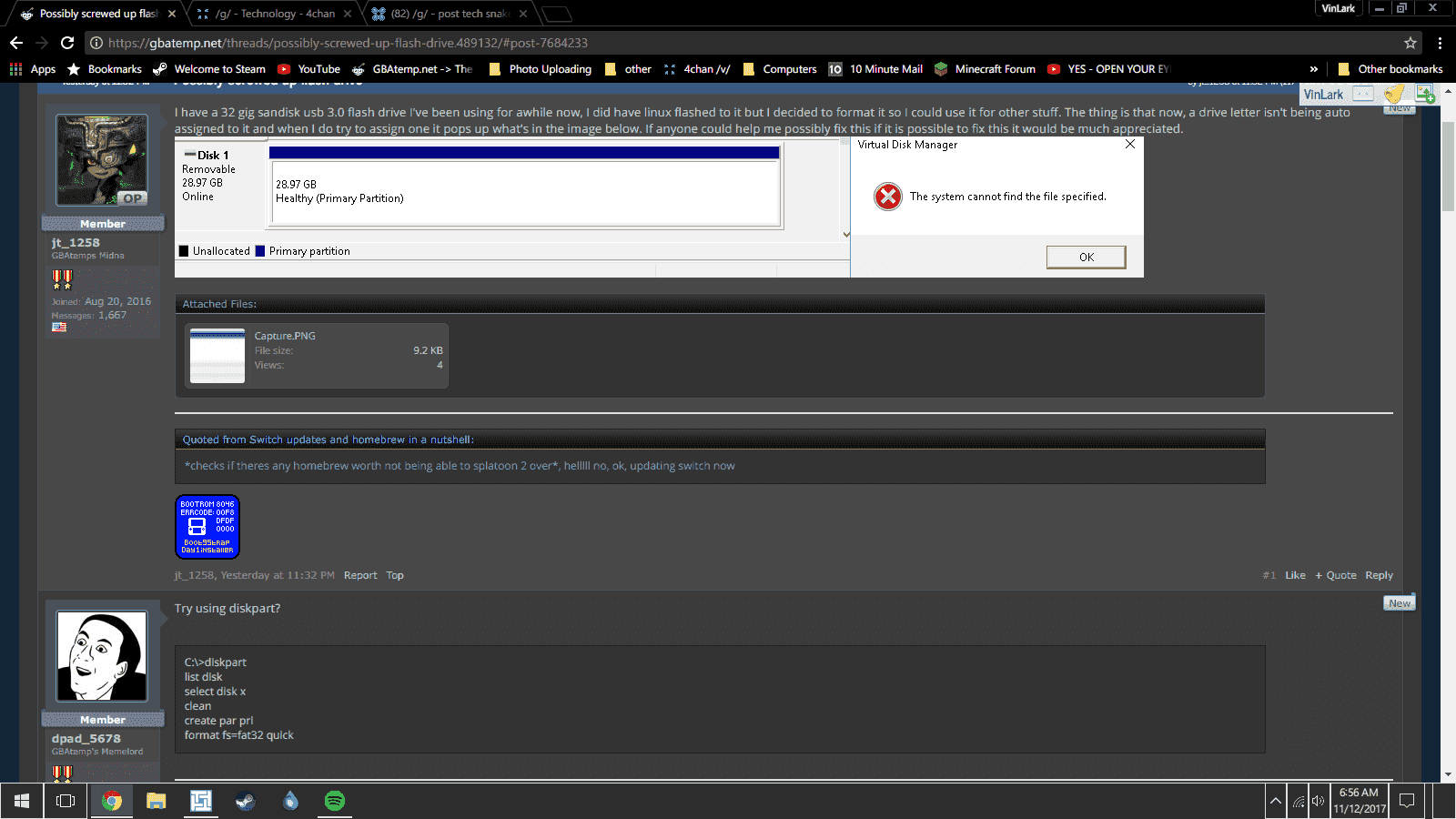

I have a 32 gig sandisk usb 3.0 flash drive I've been using for awhile now, I did have linux flashed to it but I decided to format it so I could use it for other stuff. The thing is that now, a drive letter isn't being auto assigned to it and when I do try to assign one it pops up what's in the image below. If anyone could help me possibly fix this if it is possible to fix this it would be much appreciated.

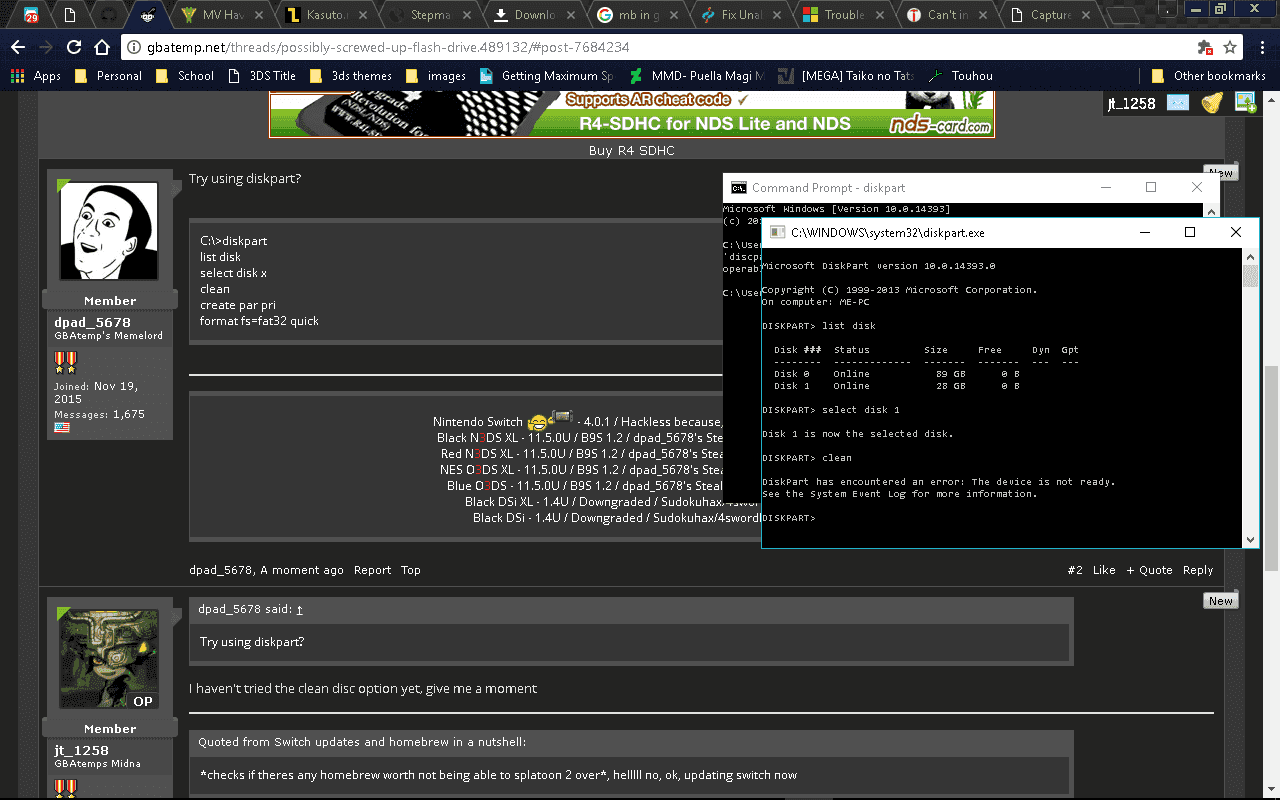

I haven't tried the clean disc option yet, give me a moment
crap
Alright, well this may sound strange: Use the Chomebook Recovery Media Creator (get it in the Chrome Web Store) and follow the instructions. After the media is created, follow the instructions to revert it back to a usable start. It's weird and sounds maybe a little irrelevant, but it's worked for me every time I had a USB drive that simply won't format.

it just seems to sit on .0% forever on deleting it...it wrote fine but now I'm not sure what to do, it's kinda midnight over here so I'm gona come back at this in the morning
though heres a screenshot of the bundle o' joy it is now
allright, it's over folks, dpads method worked and my drive is fine again, that'll do folks and thx for the help
