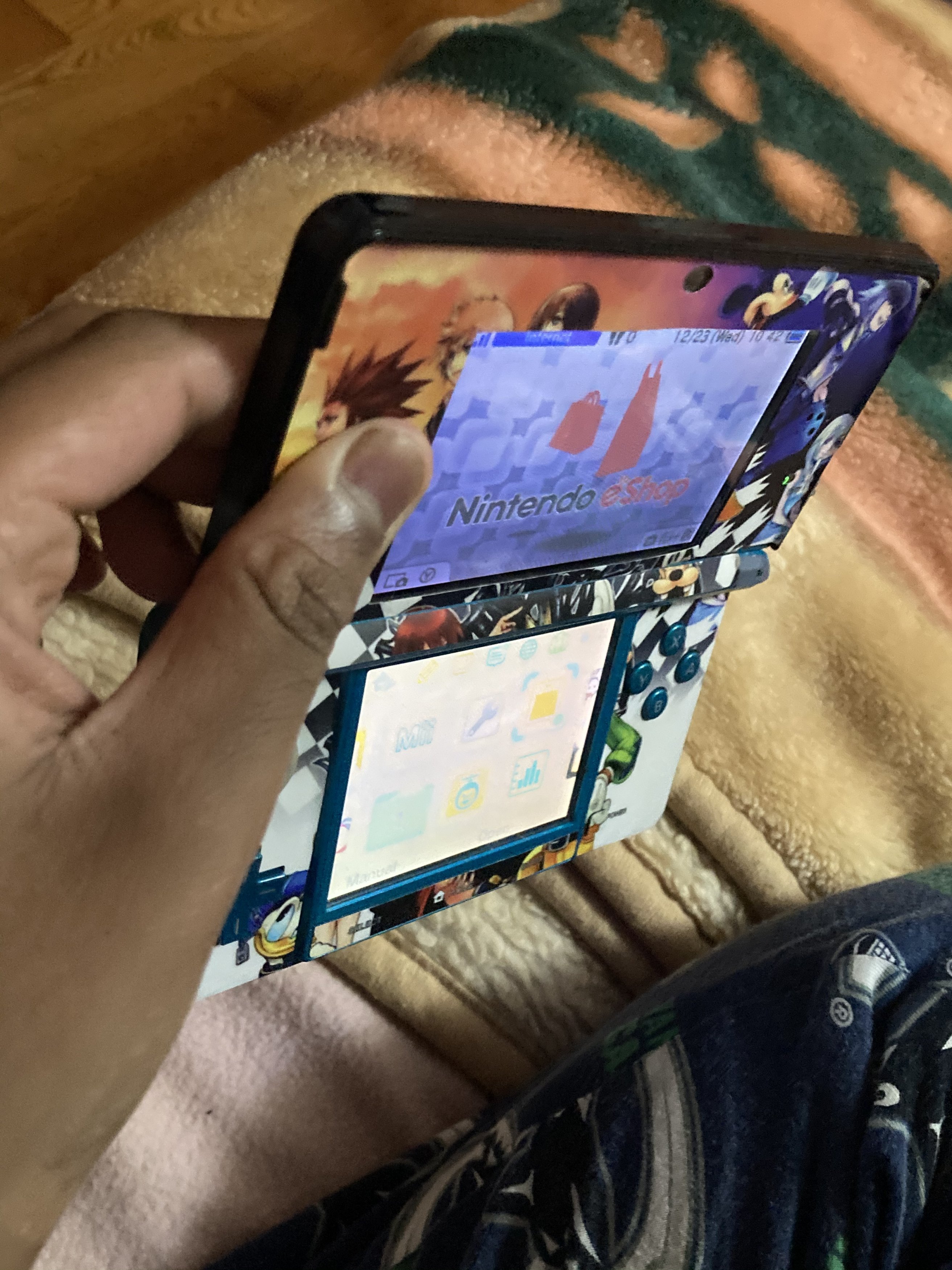

    Well, this started a few days ago. I was playing a GBA VC game and suddenly the top screen started flickering and, eventually, fading out, showing me nothing but a black screen.
    Tried a couple of stuff I saw here and there - letting the battery run dry and charging the console - but with no success.
    I was at firmware version 11.4, thought this could be some software bug and updated the 3DS: no success
    Formatted the 3ds: no success.
    Why am I thinking this could be a software problem? Because if I try to run FBI the top screen starts working again, showing the FBI logo. If I hit the home menu: it starts to flicker and fading away. And if I boot to Luma menu the top screen works, showing all the available information.
    TL;DR:
    3DS screen started flickering and blinking from nowhere; no damage to the 3DS hardware
    3DS Version 11.5
    Luma 3DS 8.1
    Boot9 installed
    I don't think this is a hardware problem, but I'm already looking for new flat cables.
    Any idea or suggestion will be very appreciated. Thank you guys.

  9. kaiobj
    kaiobj Member
    13
    Sep 13, 2009
    So, I'm reviving this thread because I got time to verify and try out some things regarding the status of my 3DS. As I was suggested, I recorded a simple video to show you guys what's going on. I could realize that if I try to run any system software related app, the top screen starts flickering and fading out. If I try to run any cartridge game, downloaded game or homebrew, the screen works as expected. For a moment I thought that it was a hardware issue, but the fact that the screen works sometimes makes things harder.
    Anyway, I still have to try replacing the battery, but I'm not convinced that it would solve my problem.
    Thanks again, guys.
    Video:
  10. kaiobj
    kaiobj Member
    13
    Sep 13, 2009
    UPDATE!
    I've found out what is causing this issue: the 3D switch (or effect, if it matters).
    When I start any homebrew and or/luma settings, the 3D effect is not able, so the screen works as expected. But anything that uses the effect is affected. I figured out when I was trying the game Severed on the 3DS. The top screen was not working and when I try to change the level of the 3D effect the screen back to normal!
    Obviously, the first thing I tried was turning off the effect through the parental control. Result: no success. Games like Pokemon and Super Mario 3D land even with the effect turned off refused to work, and I have no idea why.
    So, my question is: is there any homebrew that full disable the 3D, making the 3DS work like the 2DS system? If not, what could I do in order to fix the problem? Could replacing the top screen solve the issue?
