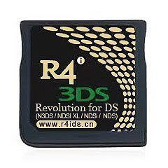

I have a flash cartridge originally purchased in late 2011, the label has long since worn off but it used to look like this:
(note that the text under the "Revolution for DS" is different to the image listed on the guide)
Is this still the same R4i 3DS Gold hardware? It runs Wood firmware and supports RTS.
jerbear64
Dec 10, 2011
304
24
381
That's the one.
