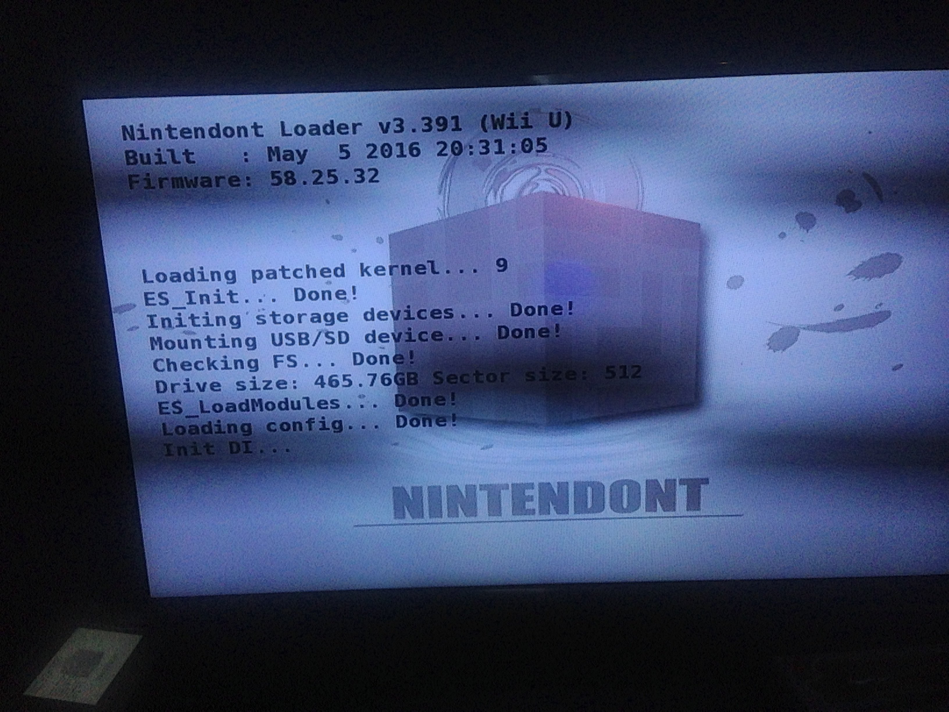

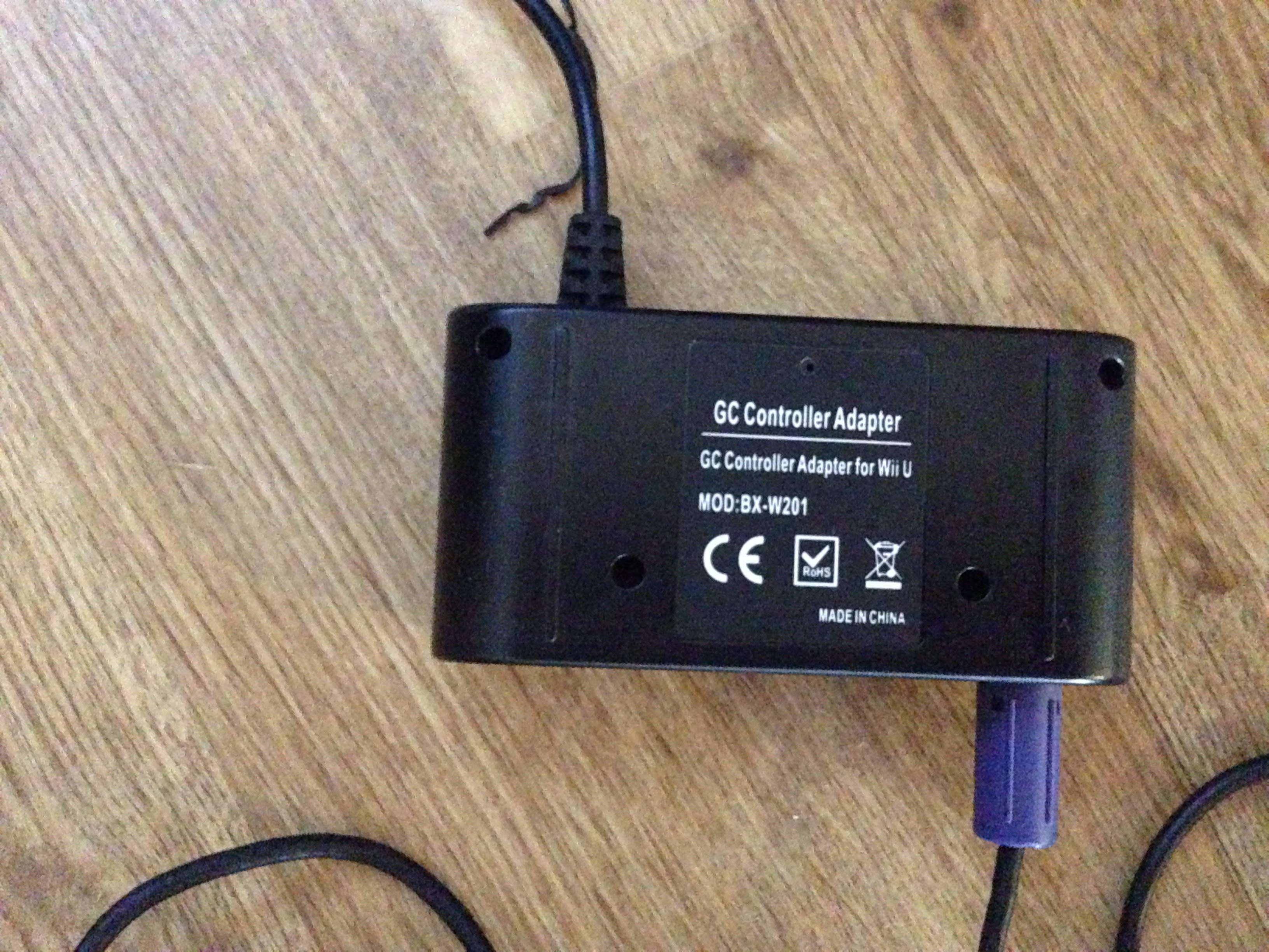

Ok Ive got a controller problem.
Im on the latest nintendont update.
Im using an official Nintendo Smash bros. gcn controller.
I'm connecting the controller with what I believe is a 3rd party gcn wiiu adaptor.
Ive got no special controller.ini file downloaded and am hoping someone can provide me with one.
THE PROBLEM
when play mario sunshine, the R click is mapped as the Z button.
The Z button does nothing
When playing Mario Kart DD - as soon as I press left or right on the analogue stick, the kart throws a super hard left or right and locks in that position.
So in sort, can someone please provide me with a controller.ini file that will fix my problem please?

The Wii U USB GameCube adapter is hardcoded in Nintendont so it doesn't need an INI file. Also what is the exact Nintendont version (ex: 3.381) So many times people say they had the latest when they didn't because they were using the old Google Code page.
Also is the GameCube controller you are using an official Nintendo one or a 3rd party version. It's a know fact that 3rd party controllers don't always work right.
If the USB Adapter is 3rd party is there a switch on it that says something like WiiU/PC? Make sure the switch is on the Wii U side as these 3rd adapters sometimes are designed for use on a computer too.

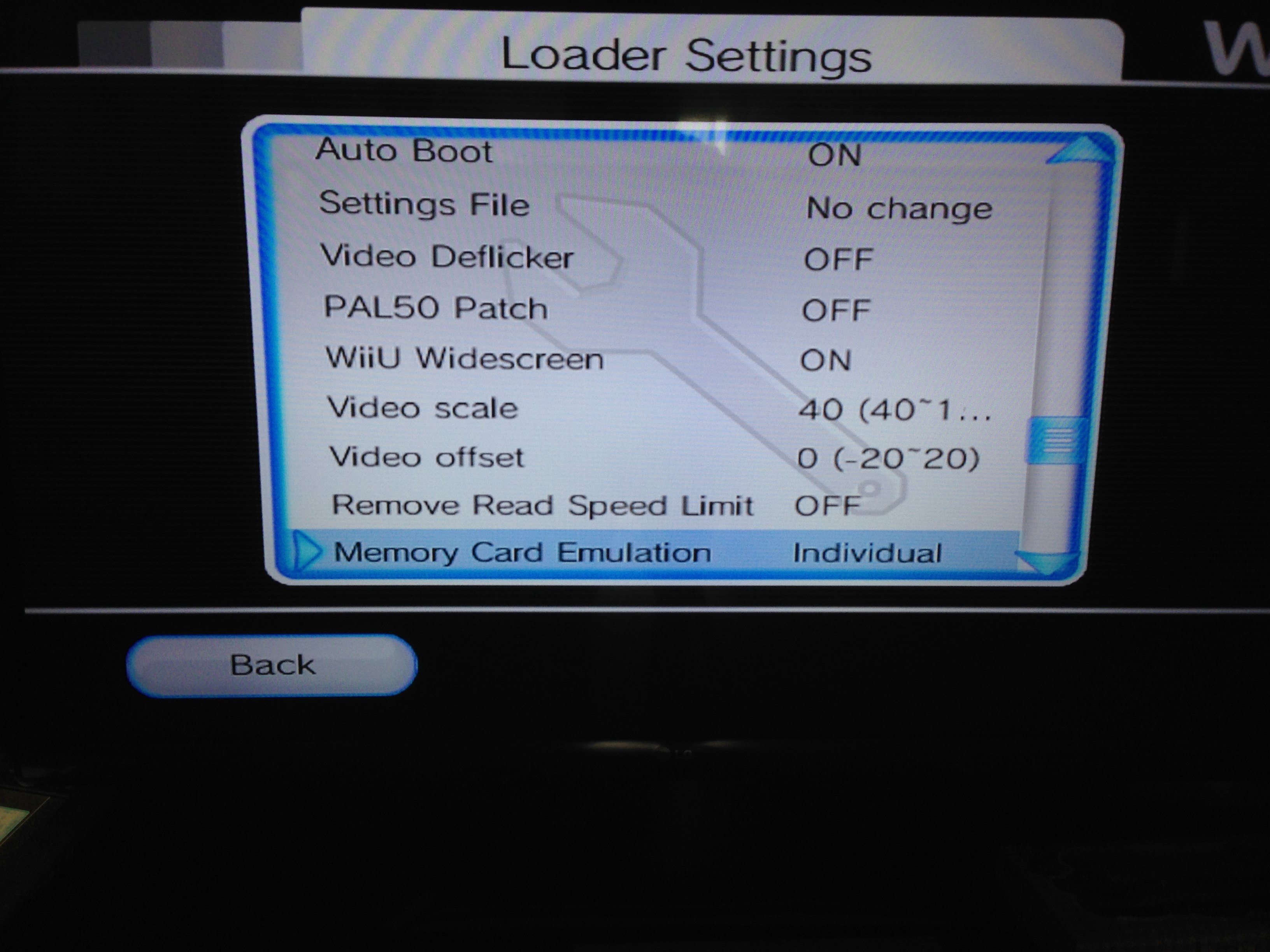

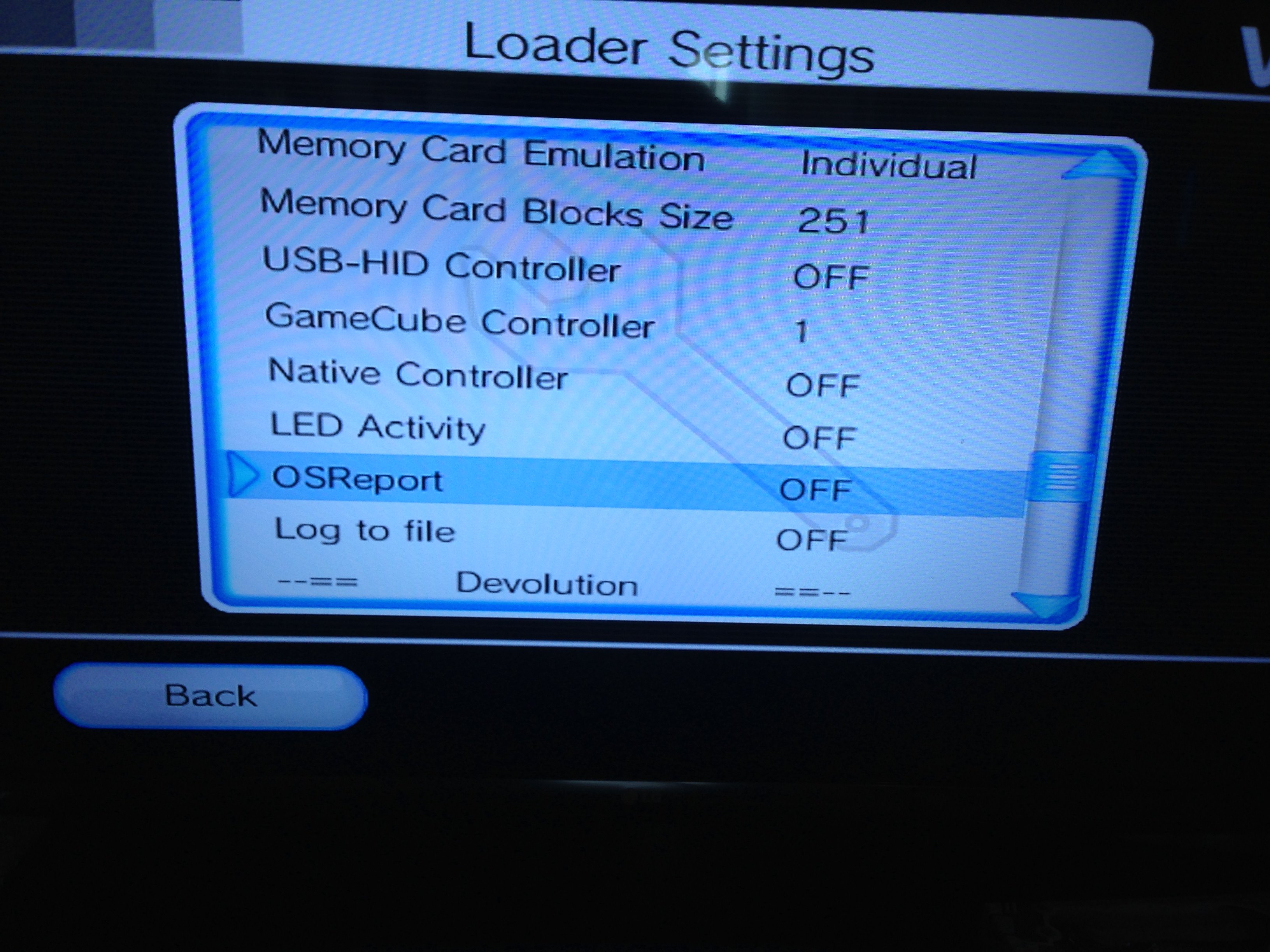

Thanks for your response. I've attached a few pictures to make clear what I'm dealing with
Prior to trying the gcn controller I had been using a ps4 with an .ini controller file sitting in the root directory of my sd card and it had been controlling perfectly.
I originally tried my smash bros. controller and then to rule that controller out I used my original purple gcn controller which came with my gcn back in 2002.
I've deleted the ps4's controller.ini file to eliminate any confusion and nothing fixes my control issues. Any help would be much appreciated.
I've tried turning on the usb HID controller option and it makes no difference.

Have you tried loading Nintendont through the Homebrew Channel? The loader you are using is out of date. There is no HID on/off option anymore. Let's make absolutely sure that it is indeed a Nintendont issue.
Also I suggest editing your post and putting the pictures inside a SPOILER tag so it keeps the thread looking clean.
How can the loader I'm using be out of date? I updated usb loader gx today!
I tried loading Nintendont directly from the homebrew channel and the same issue persists.
I've got my HDD in the top usb port and the power for the HDD in the front right usb. I have the gcn adapter plugged in to the bottom rear usb port and the left front port.
Interesting fact - when I directly go into Nintendont and slects a game. Before I load the game if I go to the options screen of Nintendont I can not navigate any of the options. I can only press the home button to exit Nintendont.

I am fairly sure it has something to do with the adapter. Remember how I said when I go to the options screen in Nintendont that I can't navigate within the screen. If I unplug the adapter I can fully navigate the options screen.
Can you recommend an adapter that works and is relatively cheap (eg not the official one)???
How about his one??
https://www.ebay.com.au/ulk/itm/261723975595
EDIT I was able to find an official adapter for $50 so I bit the bullet and purchased it.

arent you plugging your controller on port 4? because logicaly every console ever made the ports go from left to right the leftest one being the 1st port unless your gc adapter is upside down?
