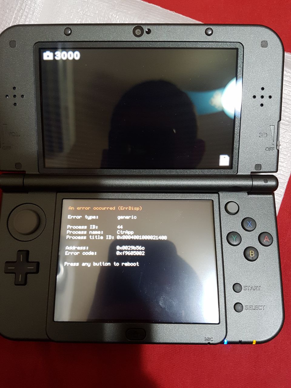

    Does anyone else face this erro before? Does have fix?
    It's a New 3DS XL.
    Boot9 1.2v + Luma3DS8.0
    Gaming in 3D it's working perfectly. Only camera and app thats use camera wont works.
    It's can be a boot9/Luma3DS inssue or a factory problem?
    Thank you guys!

    Probably a Luma issue, have you tried Luma 8.1 or the latest nightly?

    Yes. I was using 8.0. So i updated to 8.1
    I'm not using nightly

    And you still have the same problem with 8.1?
    I think the latest nightly fixes some issues.
    It could also be a bad firmware update, or maybe the camera is faulty?

    Try re-installing camera related system files.
    Download 3DNUS
    Copy each TitleID into the box:
    USA
    OR
    EUR
    then hit Download, you'll get those .cia's, install with FBI.

    did the cias work for you? having the same problem with my games

    I tried. Didn't solve. When i tried to open camera it's give a error and leave camera, but crash and i need to shut down.
    Could camera be broken? I never tried use camera before hack. Out box direct to boot9
    NO :(

    the camera's flex cable is having problem
    fix it yourself or call for somebody's help
    the last solution is to send it back to Nin-san's base

    dang, could be Hardware problem
    did u try FBI and use 'scan QR code' thing?

    I have the exact problem. I think it's hardware problem because it's only occured if I used my 3ds on 90 degree position or less. The problem will gone if I use my 3ds all the way down or 180 degree
