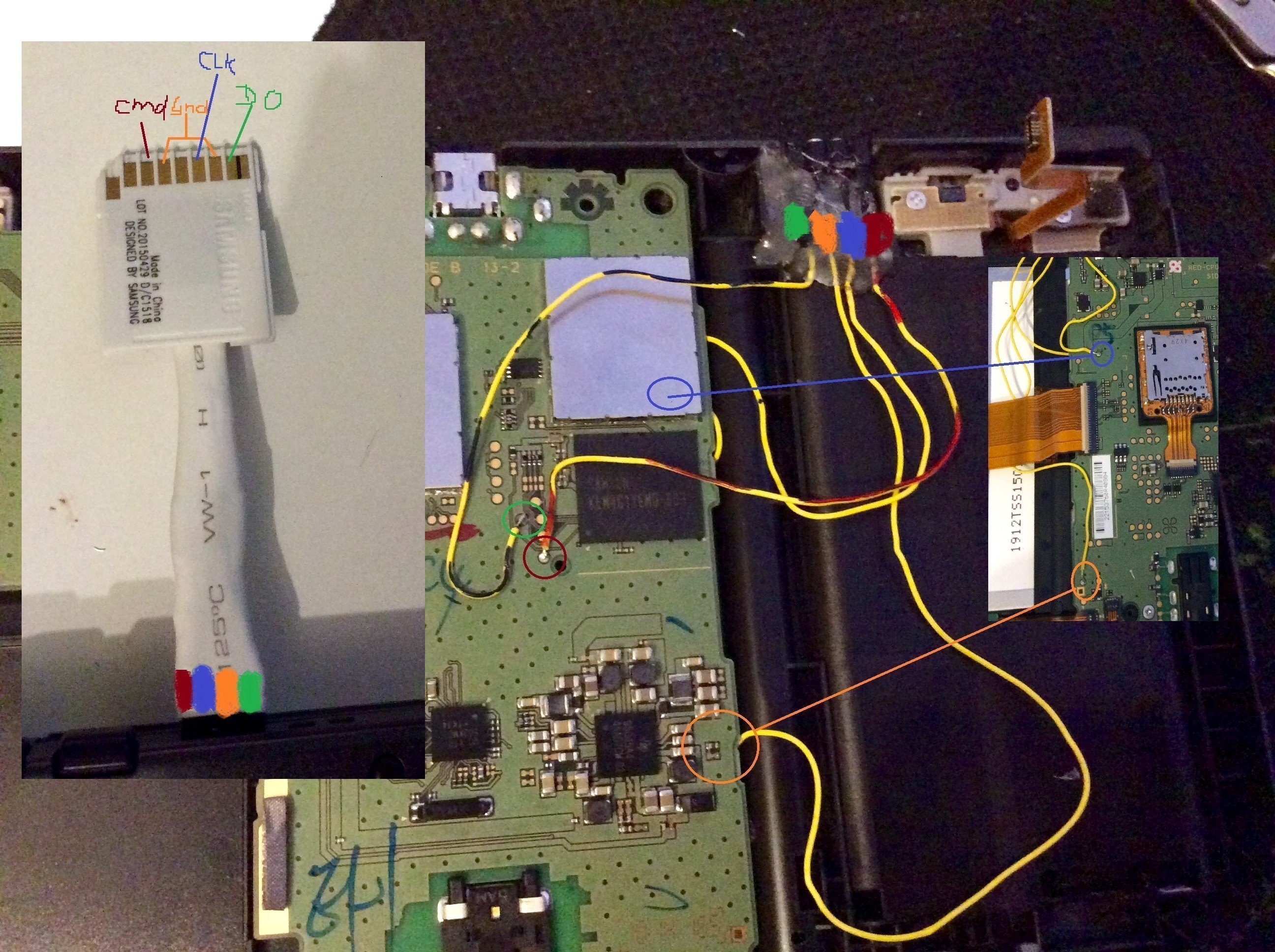

I have mapped out how the SD card reader will work with the slot moved.
layout-bmp.49388

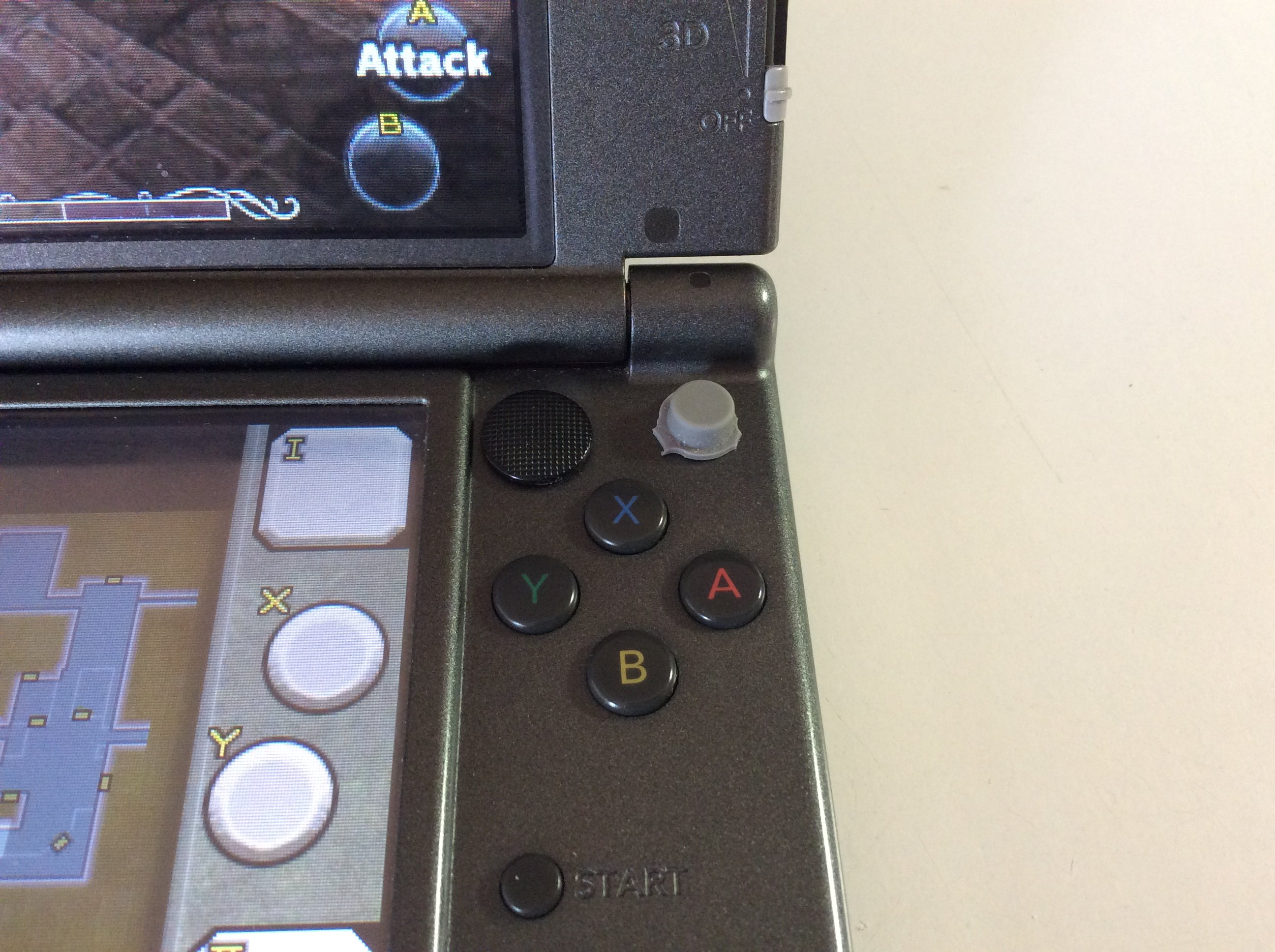

i have a psp-1000 nub as c stick and i love it, but don't just plug it on the c stick holder, glue it in, makes it feel so much better.

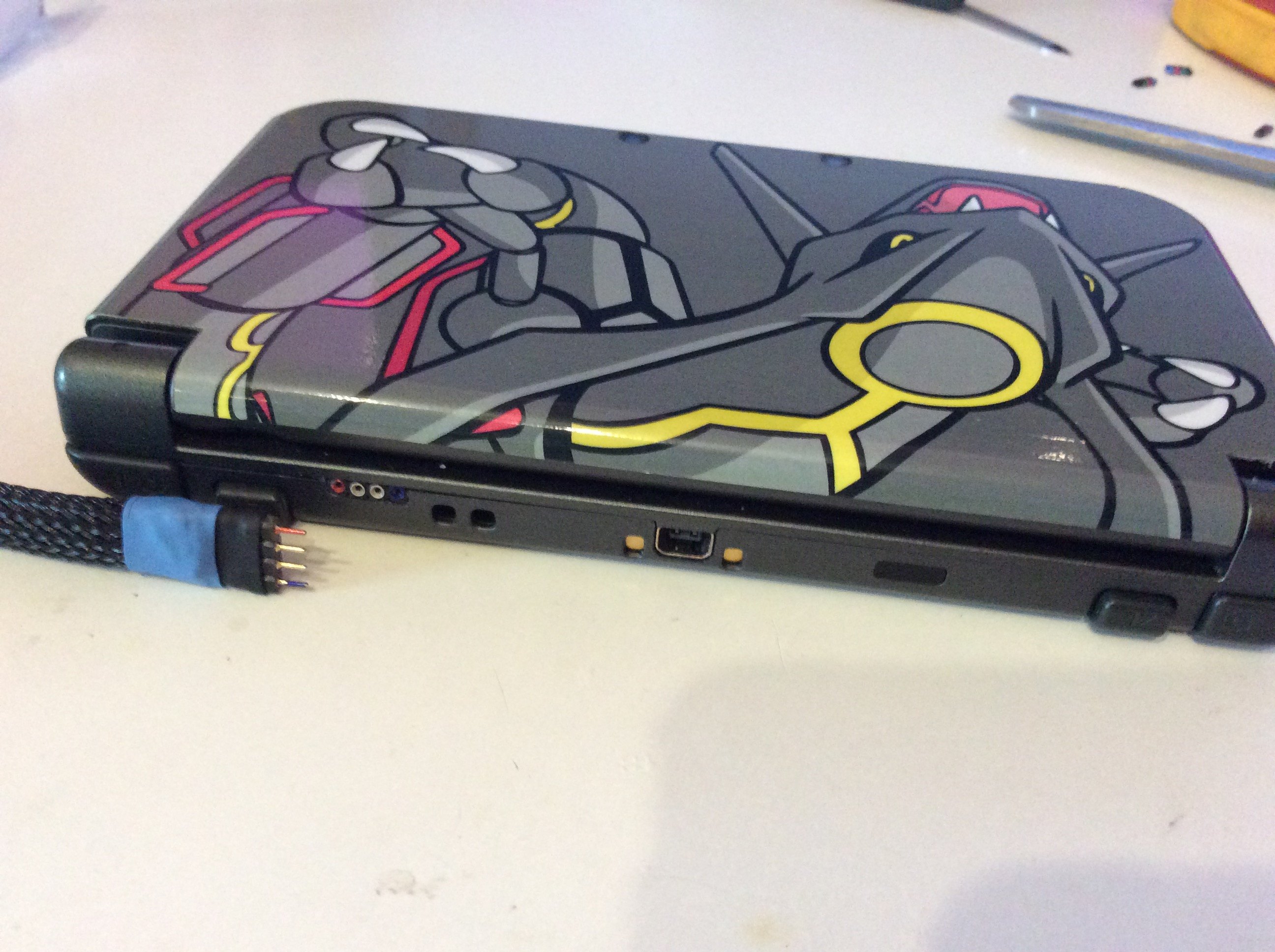

Here is my c stick/psp mod =)
and my current hardmod, i already have a micro usb b franken sd but i'm waiting for my adafruit micro usb port so i can replace my current setup to a micro usb port ^^
IMG_0130.JPG layout.jpg , you could use my pictures for reference purposes =)
