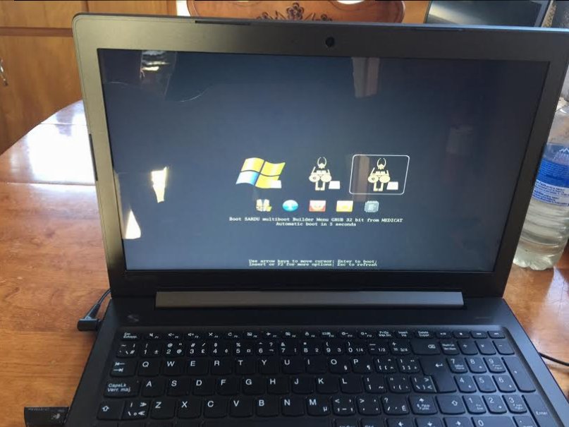

So after Installing on a stick I tried on 3 different laptops, on the oldest machine Dell XPS15 approx 8 years oldit would boot and launch the main screen to choose going in to mini Win10 which it would do, and it would tell me wireless connections were available however the PENetwork utility would not launch and I could not choose a wireless network. On the two other newer machines a 4 year old Samsung Series 9 and a brand new Lenovo Ideapad 310 I ran in to the same problem... the main menu would not load and I was presented with the below screenshot, and if I chose an option it would either hang or I would get what you see in the second thread.... Any idea how to get around this on the newer machines?

Turn off UEFI booting in your BIOS settings, it has to boot from Legacy (CSM?) mode.
I had to set all settings to legacy mode on both of the newer laptops and it worked!
