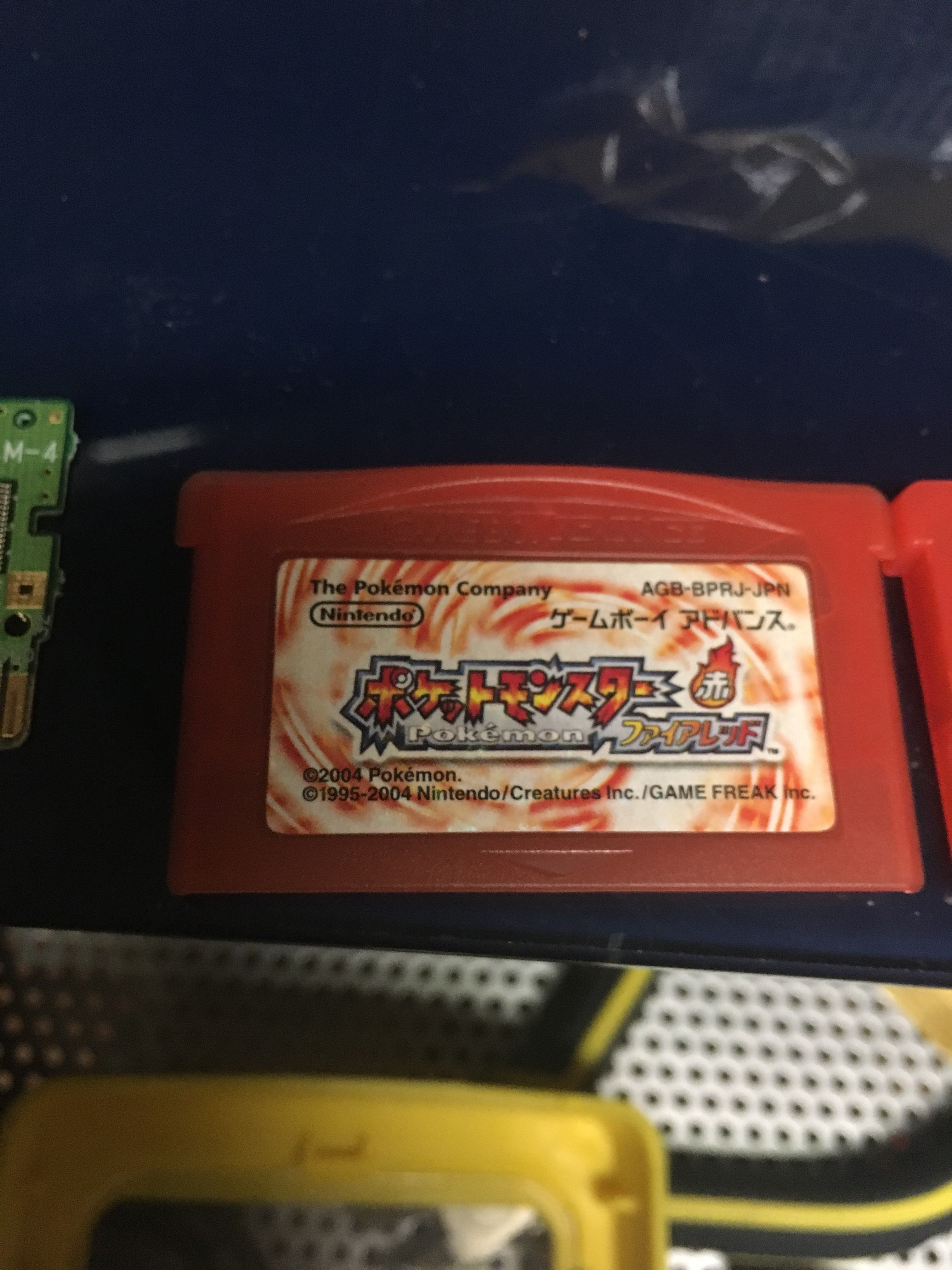

I recently ordered this Japanese Fire Red online from EBay, it works fine and I’ve been using it for a few days but a few things I noticed, the screw holding it together looks really new and the cartridge looks almost just taken out of the box. It has Nintendo on the motherboard but just wanted to post pics to see what you people think, thanks :)
