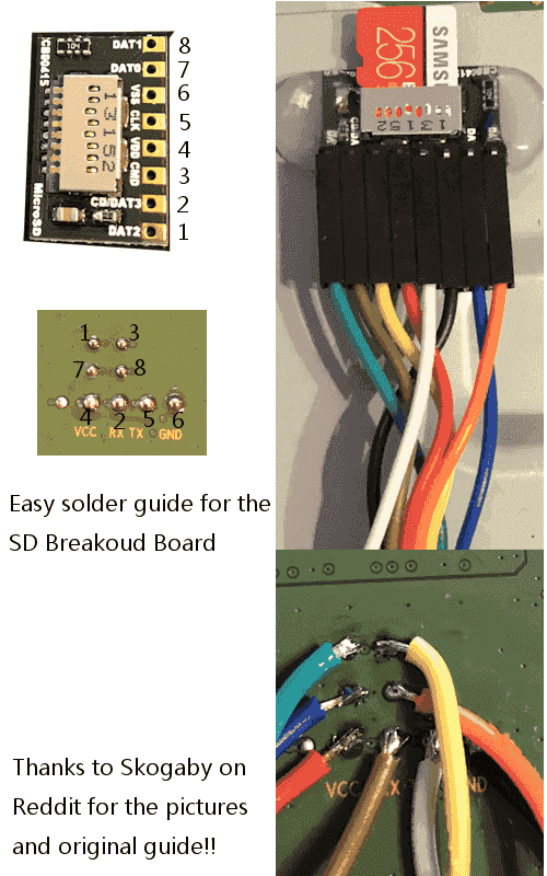

I made a quick guide for soldering the breakout board following Skogaby's tutorial on Reddit.
As I'm just diving in the extended memory mods, when the guide says to add games to X folders, do I put in the rom or the folders which hakchi turns the rom into? (those "CLV-H-AKBHR" folders) Thanks!
Oh and after all this is installed and I want to add games, I use the hakchi2 supplied in the guide right? Skogaby's mod? For more info, where are the saves stored so I can back everything up to the SD card?
and now there is no need for this expensive breakout ^^
but some days to late for you.
it need only a normal breakout board likle this
https://www.ebay.de/itm/Micro-SD-Ka...e=STRK:MEBIDX:IT&_trksid=p2057872.m2749.l2649
my Micro SD Mod
