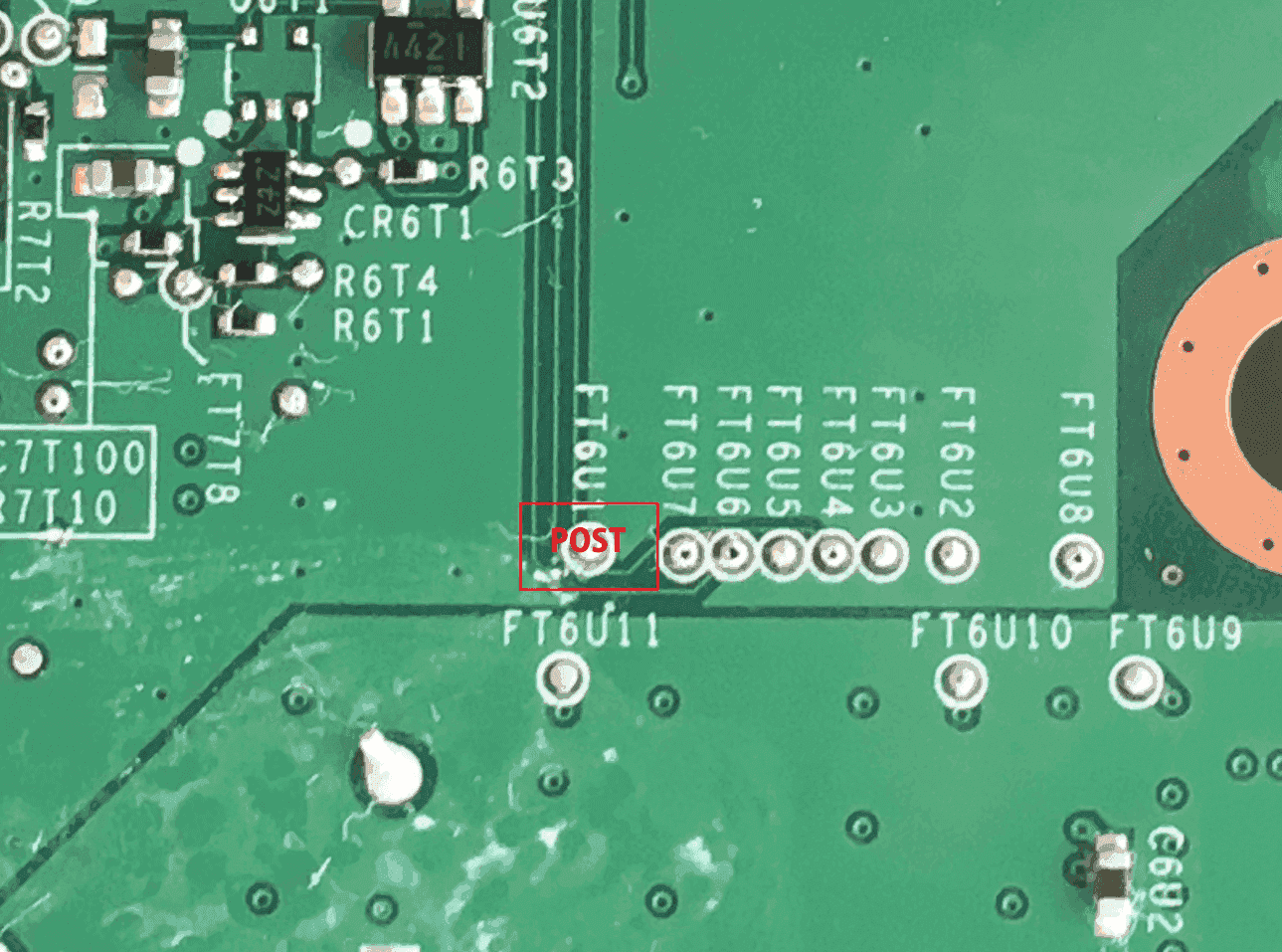

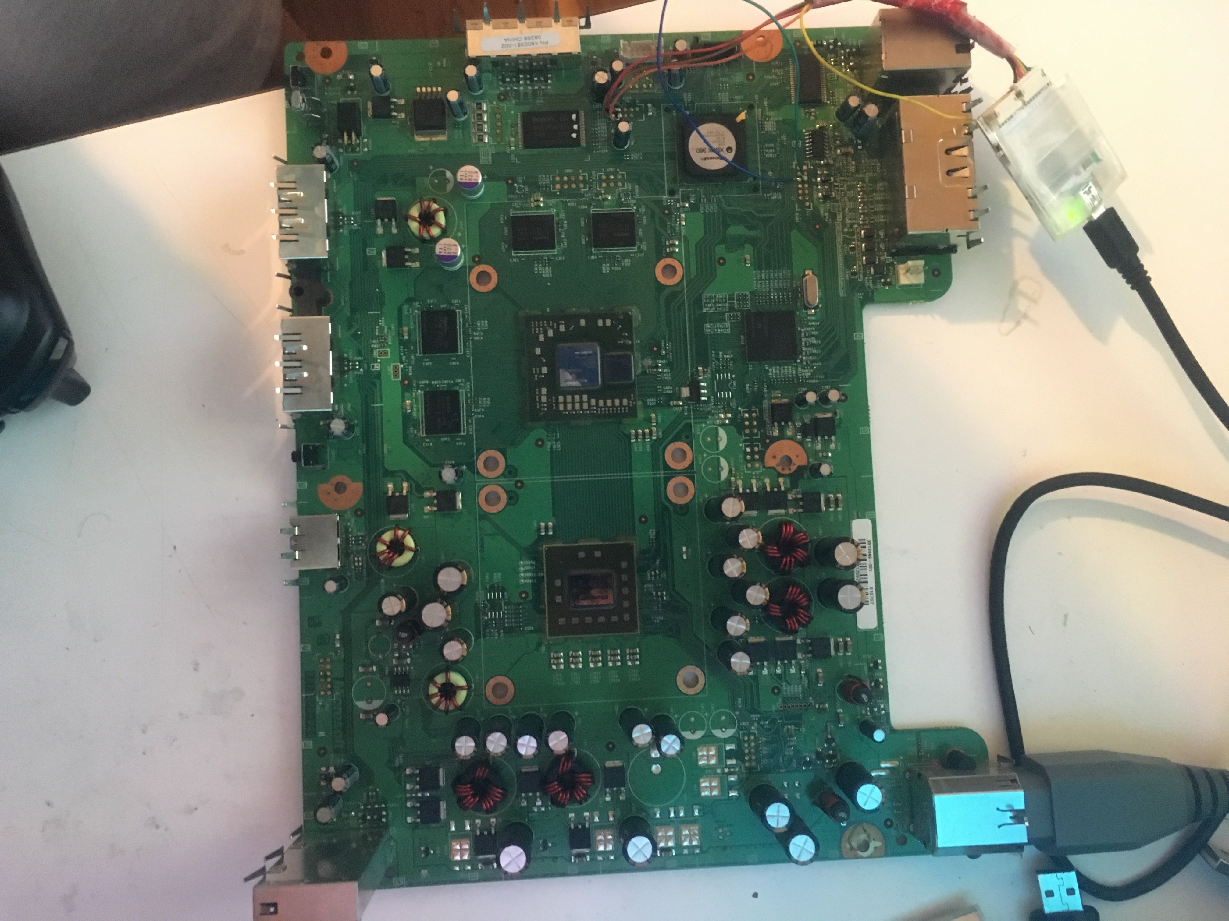

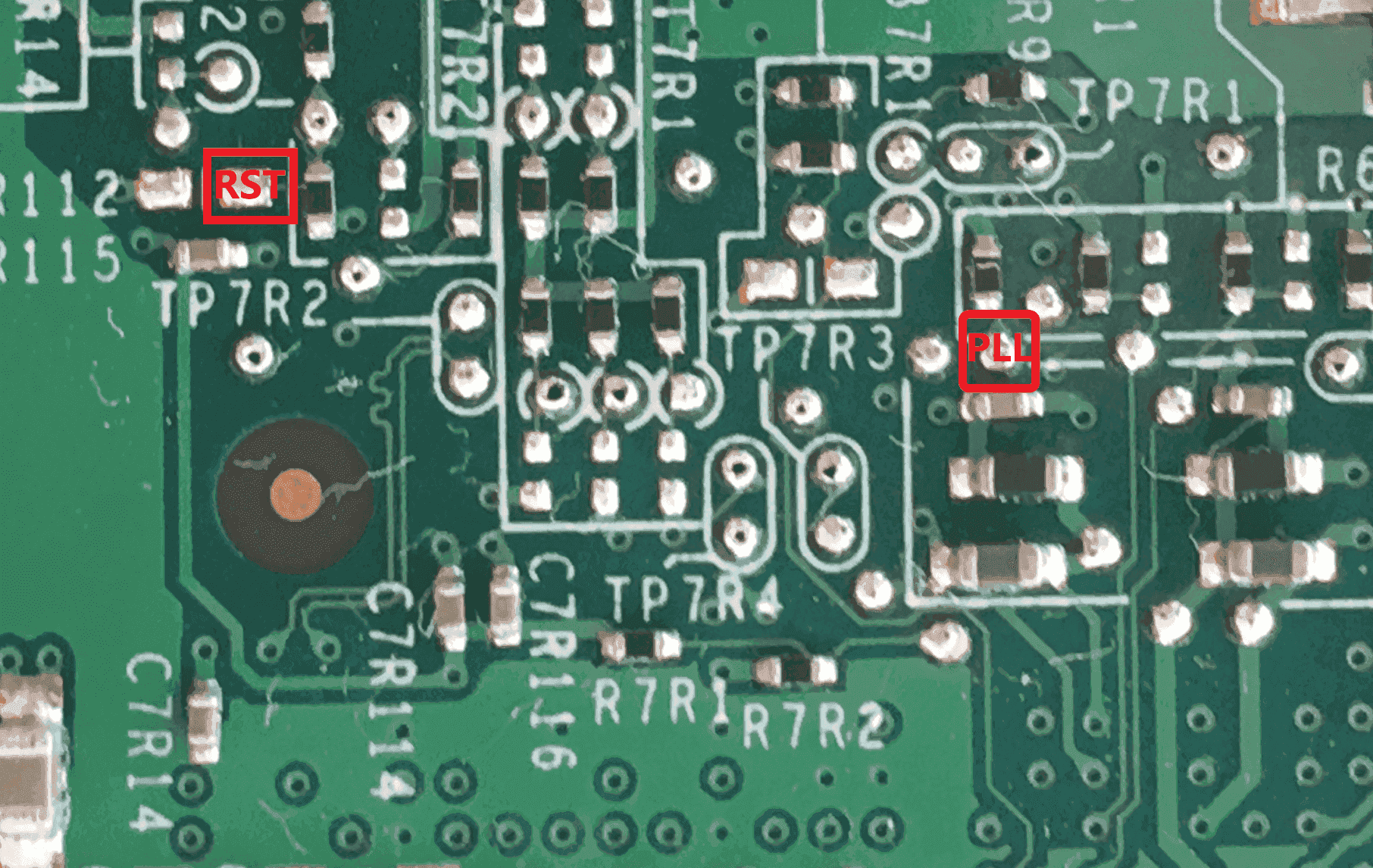

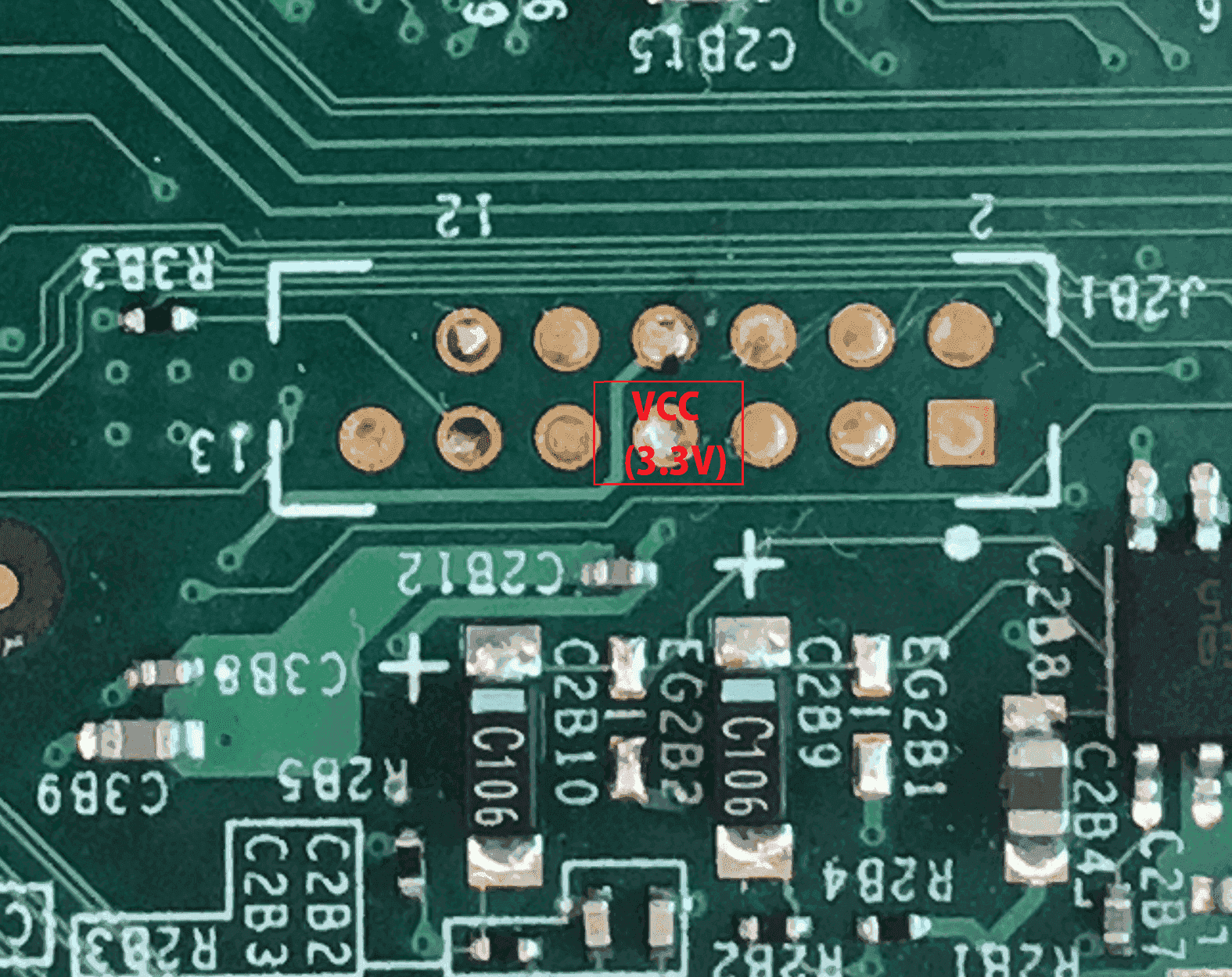

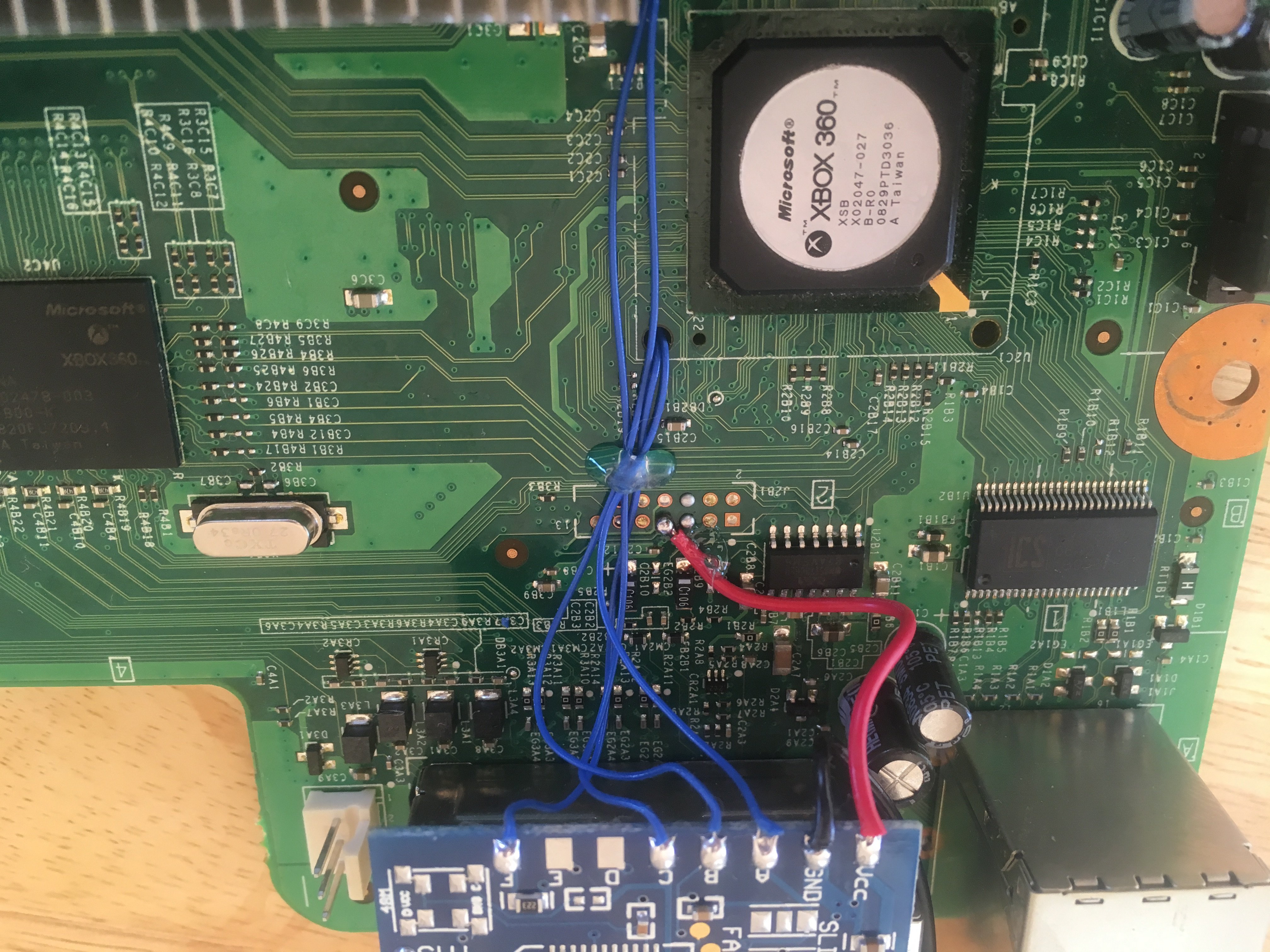

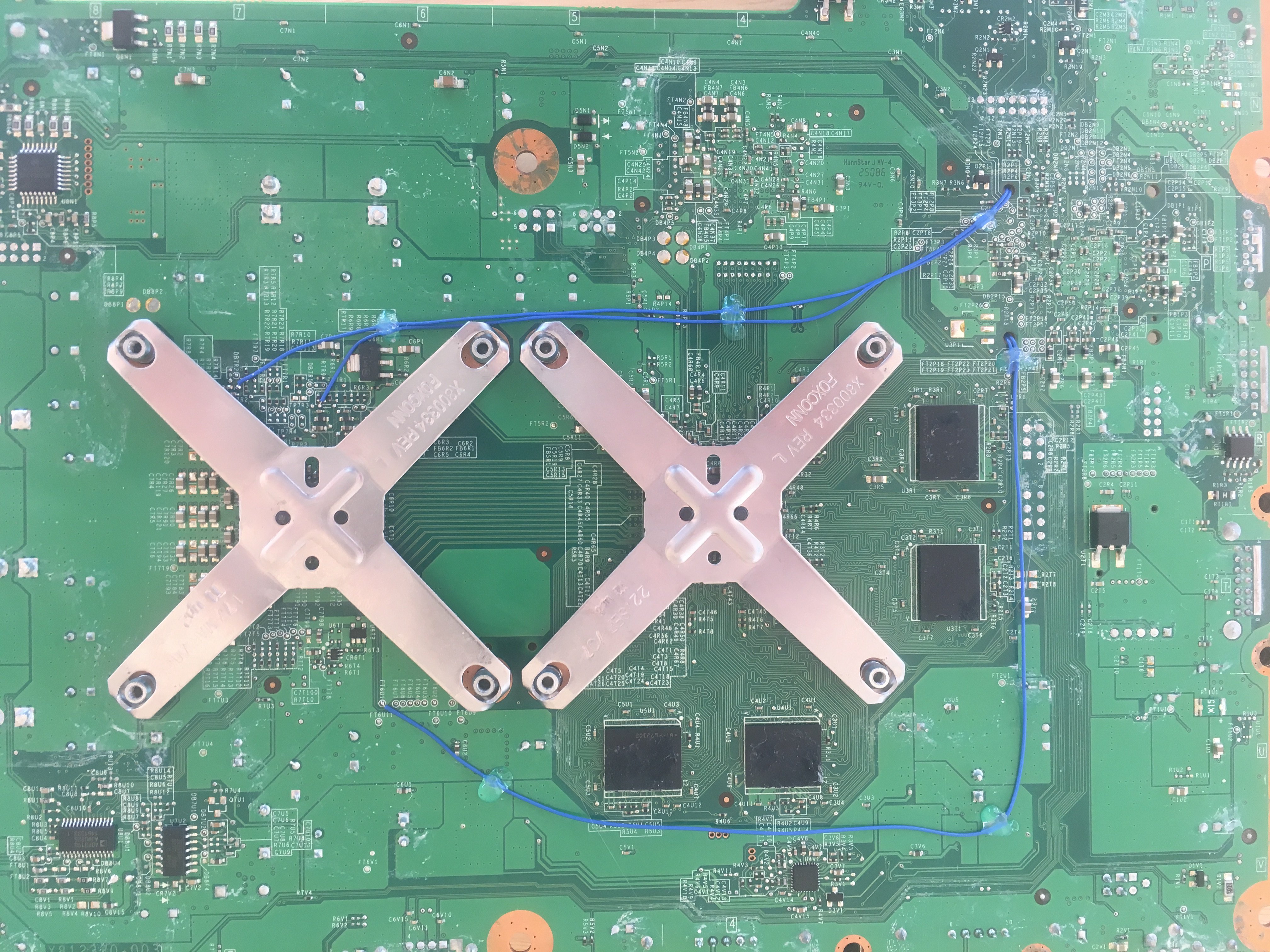

RGH.
This is pretty much the same as the JTAG.
However it has some differences.
First of all this hack is achieved with a special modchip that glitches the 360's boot process.
Then once it's "glitched" you can do everything a JTAG can do.
You can optionally also install a couple of switches and set up a so called Dual NAND.
This will allow you to retain your Live enabled state of the 360.
If you want to RGH your 360 then you'll have to know your dashboard first.
If you're on 14699 and below on Phats then you can use RGH1 (RGH1 is much more stable and quicker on boot then RGH2)
If you're on 14717 or above then you'll have to resort to RGH2.
Dashes 15xxx and above use a new set of timing files but they still use the wiring of RGH2.
Xboxes that are great to glitch: Opus, Falcon, Jasper/Kronos, Trinity, Corona/Corona V2.
Xboxes that also work are Xenons (14699 only) and Zephyrs, but their a pain to glitch and some don't glitch at all.
Corona V2 needs a special method of dumping the 4GB NAND.
You can dump it partially (48 MB iirc) or the full 3.8 GB.
The full 3.8 GB is rather slow but if you want to do it right the first time then dump the full 4GB.

RGHing your 360 comes with a few extra steps.
First of all, determine what RGH type you'll need to use by your Dash version.
RGH1:
RGH1 is used for Phats with a dashboard equal or lower then 14699.
RGH1 uses only a few wires and is faster then RGH2.
RGH2:
This hack is designed for the Slim, but is also used on 14717/14719 and 15572+ Phatty 360's.

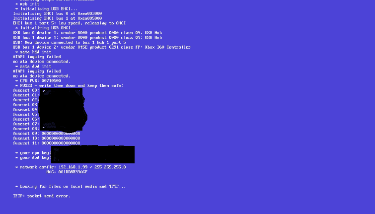

DGX:
This method is only used to retrieve CPU keys from Slim consoles that have been updated to 15572 or higher.
If you want to glitch your box with this other then rescuing DVD keys then I advice you to convert it into a RGX.

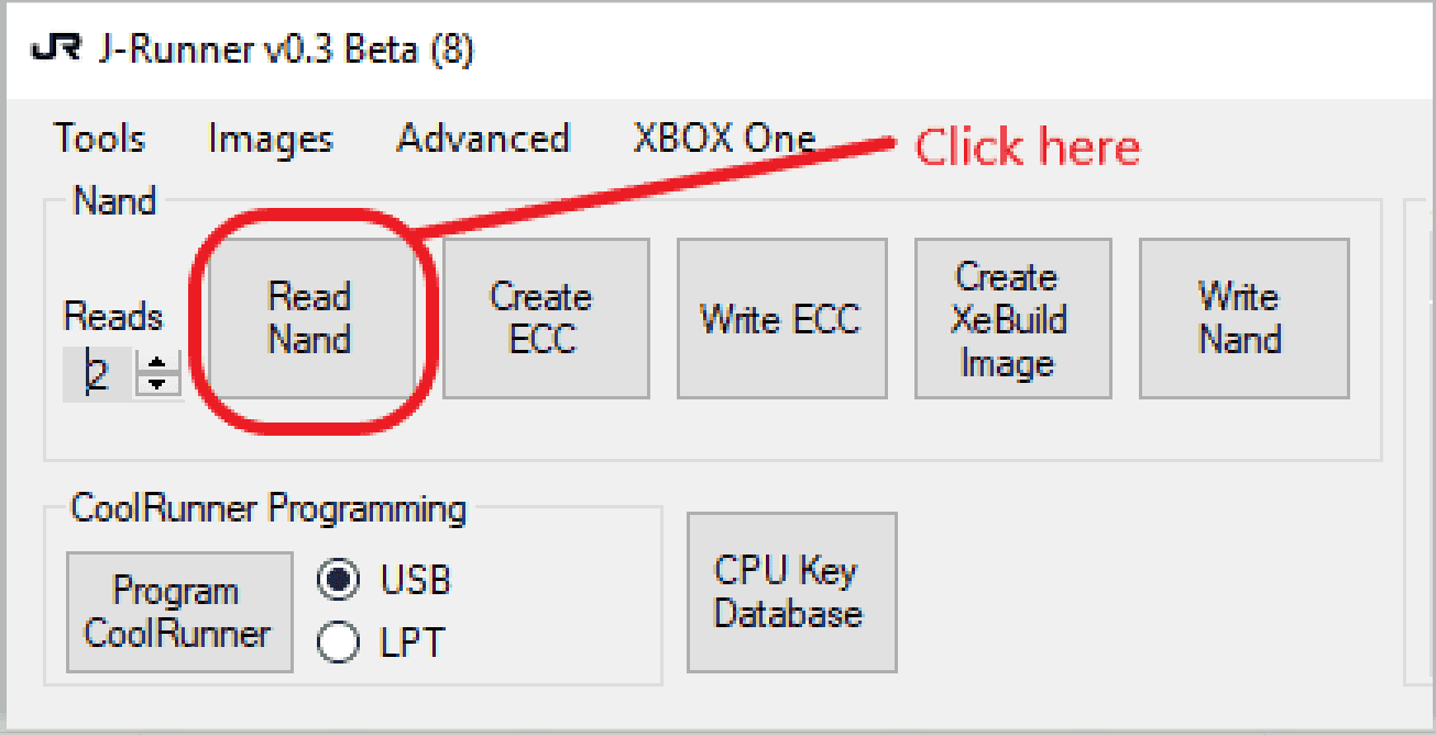

After that you'll need to dump your NAND.

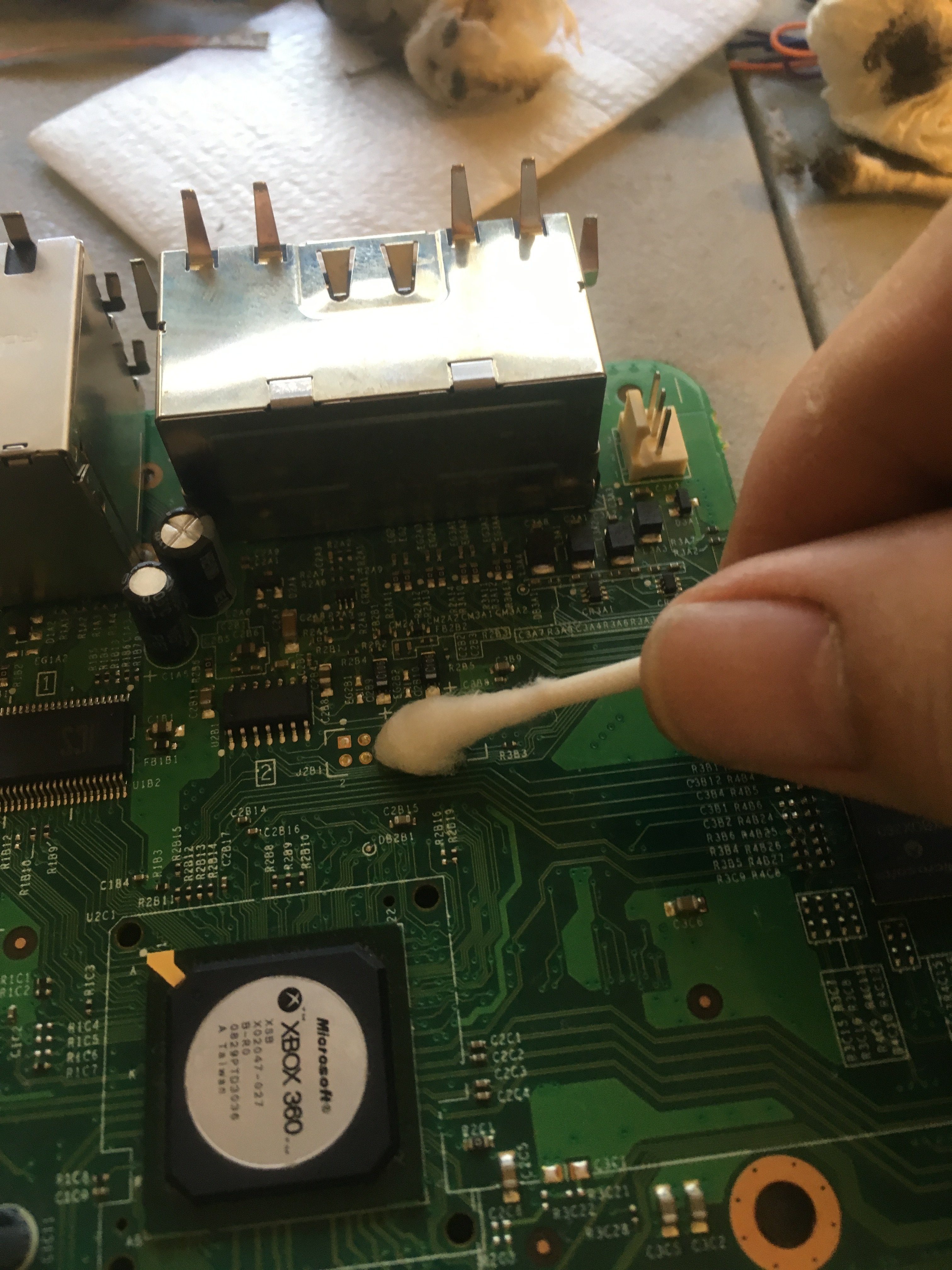

Preparation: Disassemble phat Xbox 360 down to the bare mobo with Xclamps removed, clean old TIM off of CPU, GPU(not necessary but highly recommended) and heatsinks, clean soldering points well, might as well clean the whole board if you can at least with a can of duster, tin(pre-solder) your modchip pads(including xilink connections on modchip if using Matrix) and soldering points on mobo, attach nand wiring to mobo, attach xilink connection wires to modchip, program modchip with file 19 for Falcon mobos and 21 for Jasper mobos.

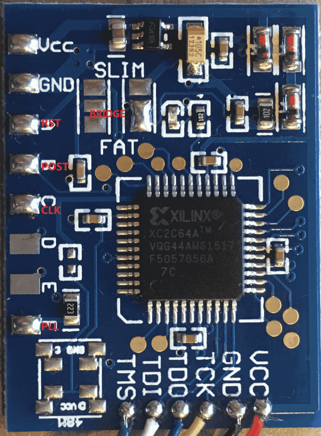

Programming the modchip is done through the "Advanced" tab in Jrunner. Click it, and navigate over to "Custom Nand/CR functions. You'll see a tab pop up. Click the browse box, and navigate to where you've stored the 15432 timing file pack.
In this instance, we're programming a Matrix Glitcher for a Falcon mobo, so we'll use file 19 from the RGH1.2 pack. You'll have to navigate to the "if you mad" folder. Find file 19, and click "Run"

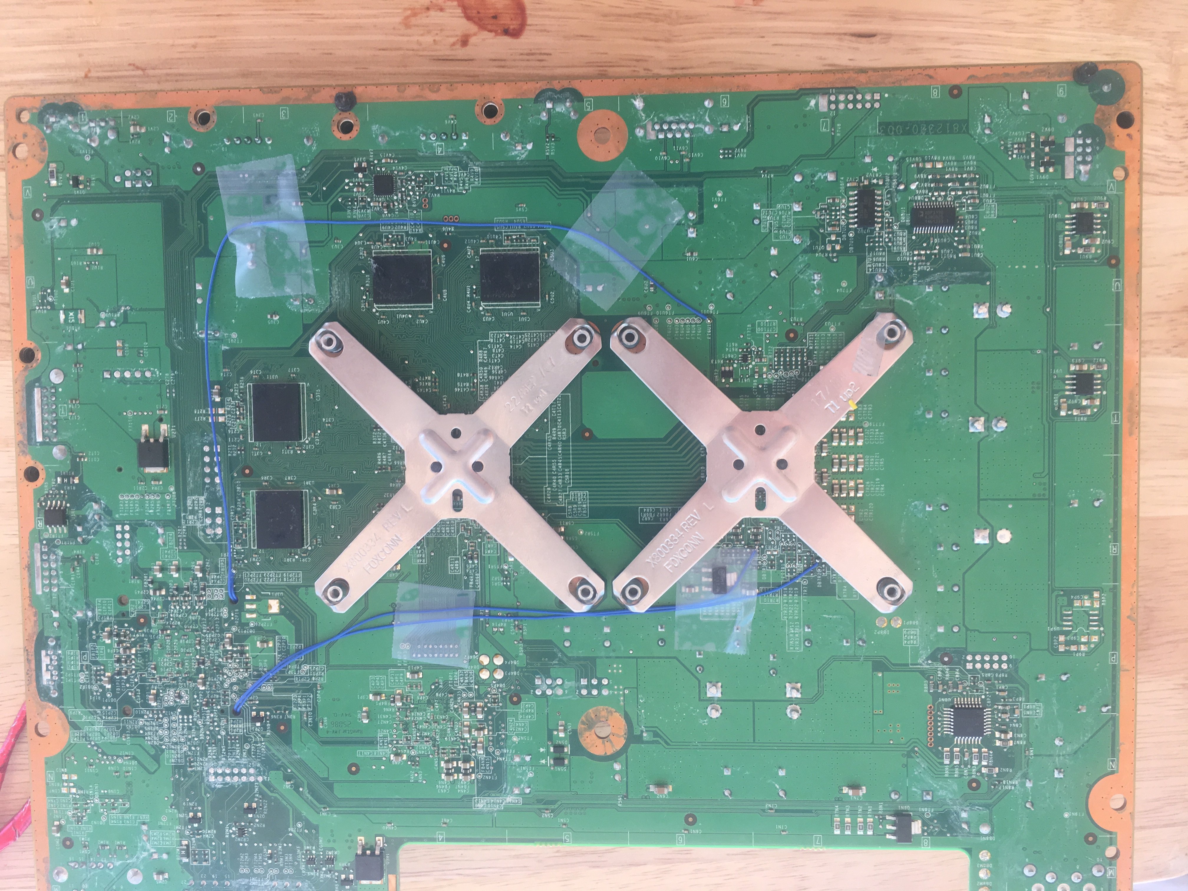

Go ahead and solder in the chip. Use the office tape to hold the wires down for now.

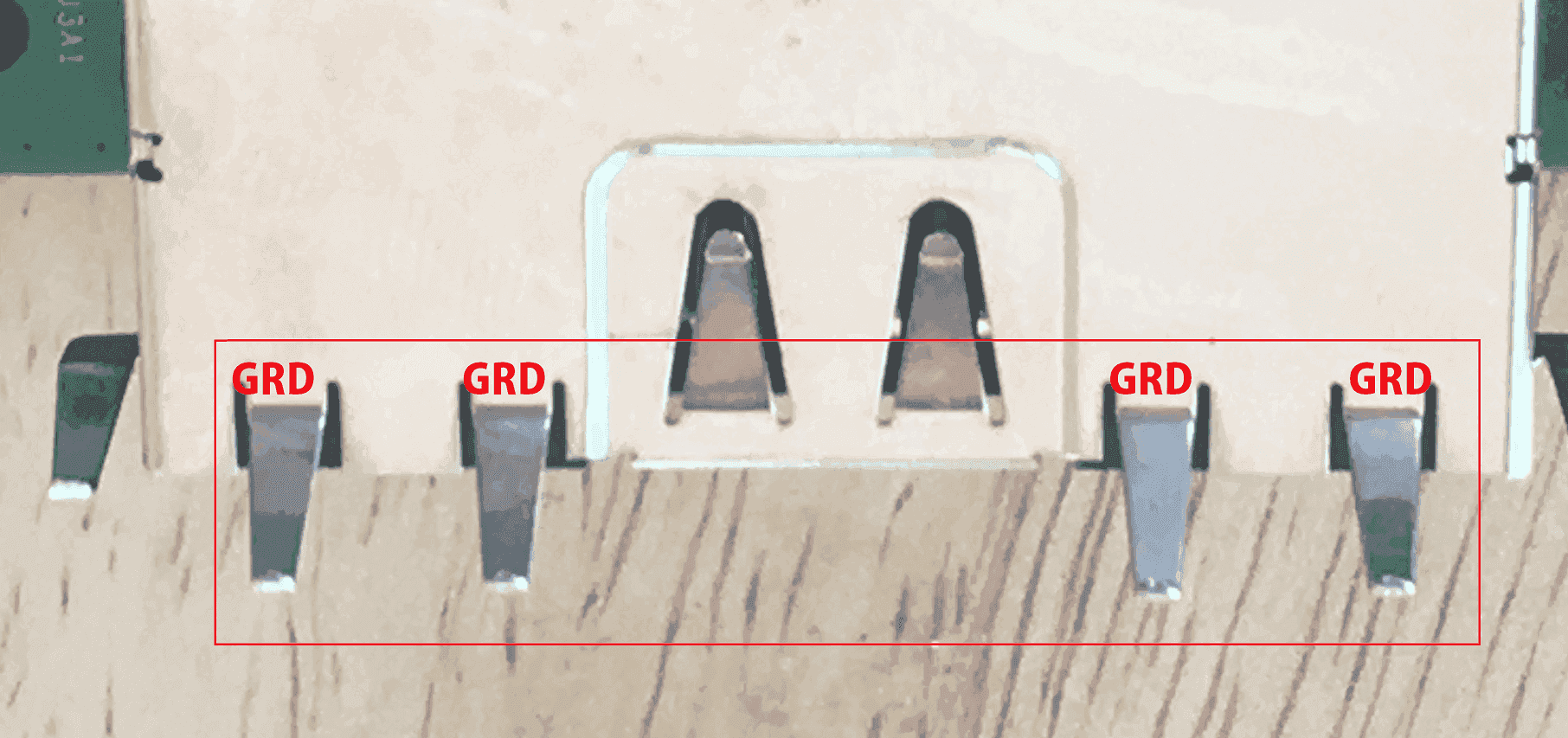

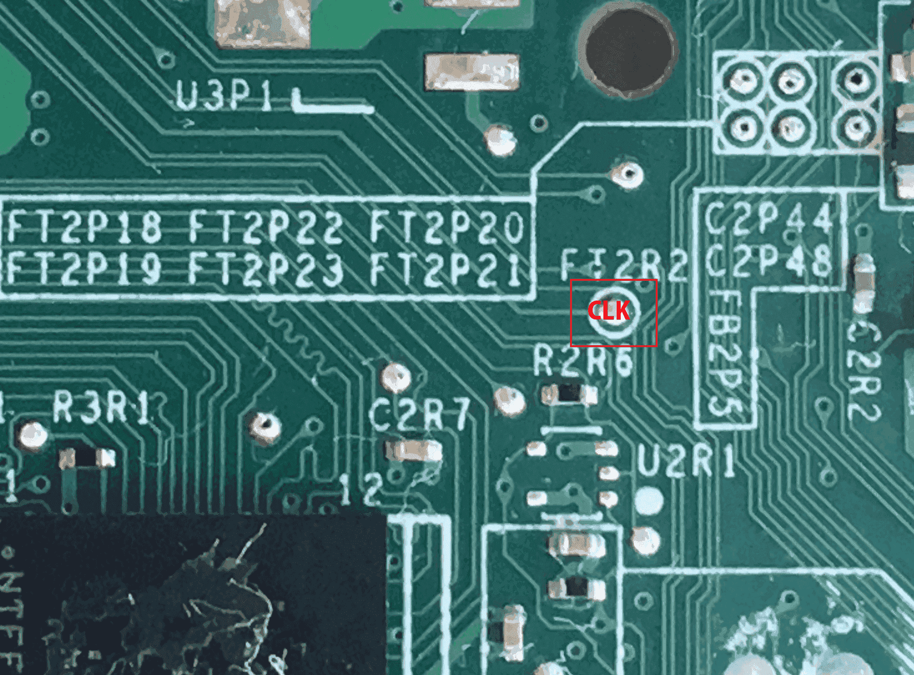

Soldering points: All of your points will be on the bottomside, other than GND and VCC(3.3v)
PLL/RST-RSTPLLFINALFINAL.PNG
(Note, these points are especially difficult as they're quite small, located very close to other components, and will RROD the console if damaged. Be very cautious and be sure to tin the points before attaching wire)
Dumping the Nand: First, you'll want to attach your JR Programmer V2 to the Nand connection wires and your PC. Make sure you have the console plugged in, but NOT ON. Dumping the Nand is quite simple with Jrunner. It was created to be linear so obviously, click "Read Nand." This will read the Nand twice and automatically compare to verify a good read.

Booting Xell and retrieving CPU key: After the ECC is written to the Nand, unplug the JRProgrammer V2 from the console, reattach the heatsinks with new TIM, pop the fan out of the cage, and place it blowing towards the heatsinks. Plug in the RF board, your A/V cable(it can be HDMI), and power supply. Press the little button in the middle and if all is well, Xell will boot and display your keys. Take a pic of your keys or write them down.
