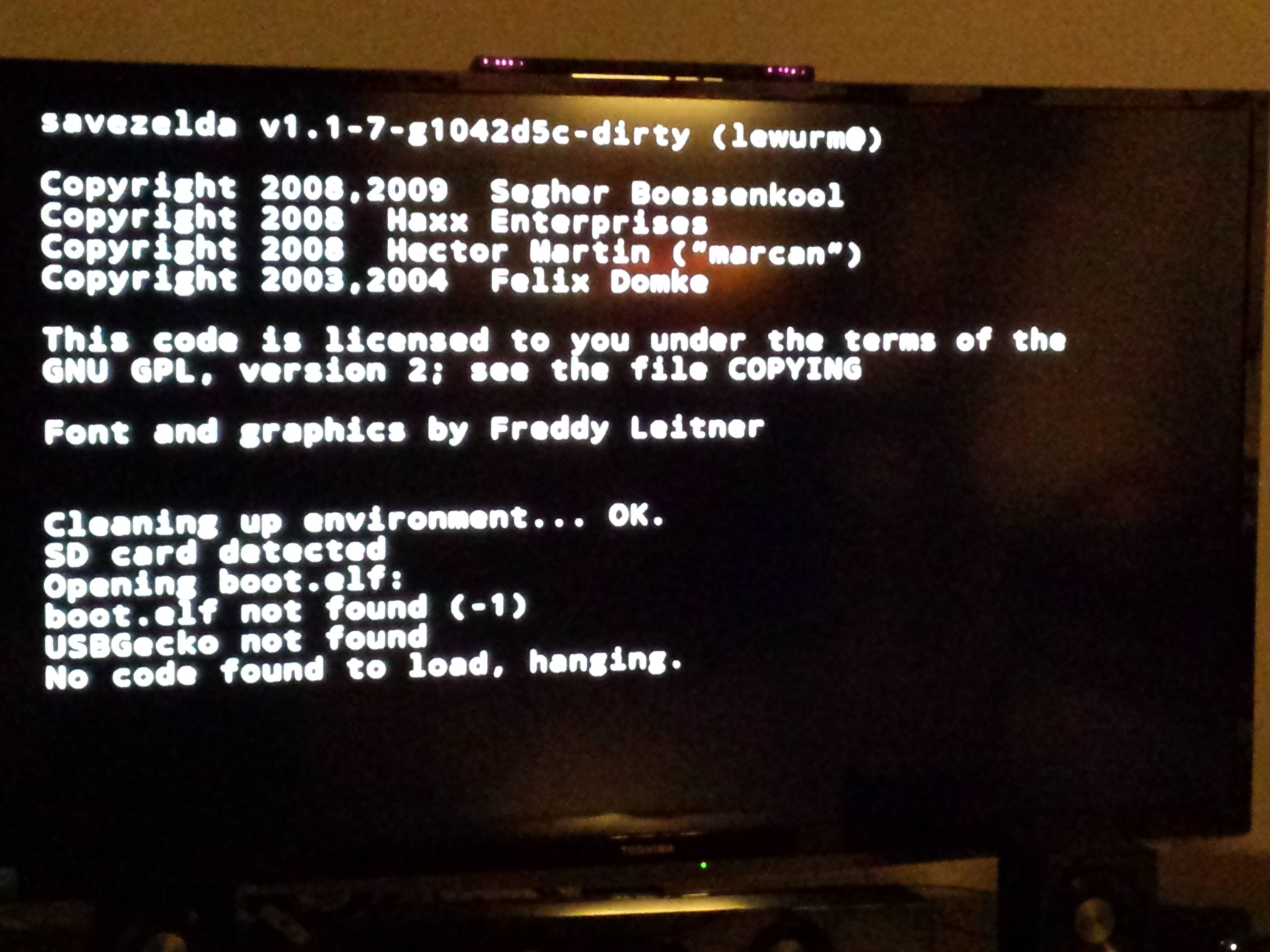

After doing all preliminary steps and bringing the cursor over the enabled character in the lowest row.. I got this
every time.. 2015110337_221115.jpg Wii u Freeze and can't HardResetbut i can take off the disc and .. Only take off the power supply...
every time.. View attachment 29363 Wii u Freeze and can't HardResetbut i can take off the disc and .. Only take off the power supply...
Refer to the folder structure in this post above, the files inside the 'hackmii' folder actually need to be on the root of your SD, the error you have basically says that it can't find those files because they aren't there. It is safe to turn the power off, I had the same error because the guide wasn't clear enough.
