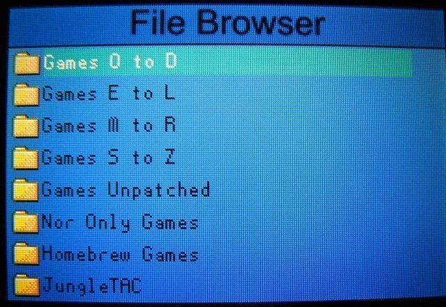

Don't forget there is a 77 rom per folder limit. If you go above this number some roms will have corrupt looking or Chinese lettering for their names. If you have a lot of roms, split them into separate folders like so:

Well it looks like cleaning the contacts didn't do anything. I guess my next step is to try a new sd card.
Gyron,
I've been transferring 1 rom at a time to see if it works so having too many roms shouldn't be the problem
