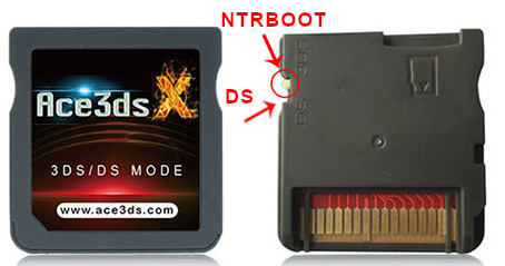

DS Flashcarts have had nothing new for ages, but now with the release of NTRHAX, the DS flashcart teams are waking up again. Since every 2 and 3ds console in existence at the moment is vulnerable, supporting NTRHAX easily has become a desirable goal. and the ACE3DS team (http://www.ace3ds.com/index.html) is no exception. They have created the Ace3DS X cart. It's quite similar to their previous product, the very affordable (sub 10$) Ace3DSPlus. The difference is a slider switch on the cart. When this switch is moved, an alternate firmware is banked in. This firmware may be booted on a 3ds using a magnet, and may be used to run SafeBS9Installer. After BS9 is installed, the switch may be moved back, and DS functionality is restored. This is the first (that I know of) released product that supports both DS mode and ntrboot out of the box with no flashing needed.

It has an sdmicro slot, as well as a little yelllow switch. This switches between ntrhax and normal ds cart mode. Runs wood in DS flascart mode. The goofy reader works but is very clunky to use because of it's width. But you didn't buy this cart for the reader. :)

3) follow guide. :) The included magnet is weak, but worked for me when placed below the B button. I sucesfully booted safeBS9Installer.
- Hardware
Sure enough, there's the usual sd micro slot, and a switch on the side. The switch appears to work as expected, allowing me to boot boot.firm from root of sdcard for my 3ds. In the other position it boots on ds through 3ds normally, appearing to be Spongebob's Atlantis Squarepantis, like my Ace3DS+ did.
Hardware wise it appears to be a cheap cart that runs a modified Wood 1.62. It also has the added bank switch to change firmwares. I'm told that the cart is fully updatable, though it is very unlikely to ever need an update. Like most cheap flashcarts, there are slowdowns with certain DS games. Metroid Prime Pinball is infamous for this, and does slow down like i expected, and like my dstt and ace3ds+ did. That said, i haven't found anything that didn't RUN.
It tends to stick in the slot a little on my O3ds, but i am able to get it back out and in. Possibly this is related to the notch with the switch in it.
It does feel a bit cheaply built, but that's far from uncommon in a cheap cart, and it functioned fine in my units, as long as it wasn't heavily jostled. Since i do not do that, it's not an issue. Shows right up when i plug it in.
